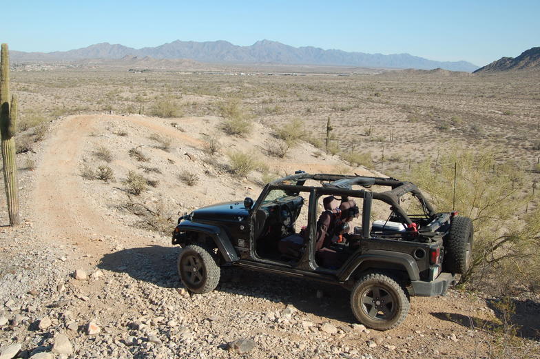

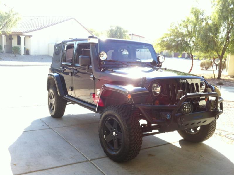

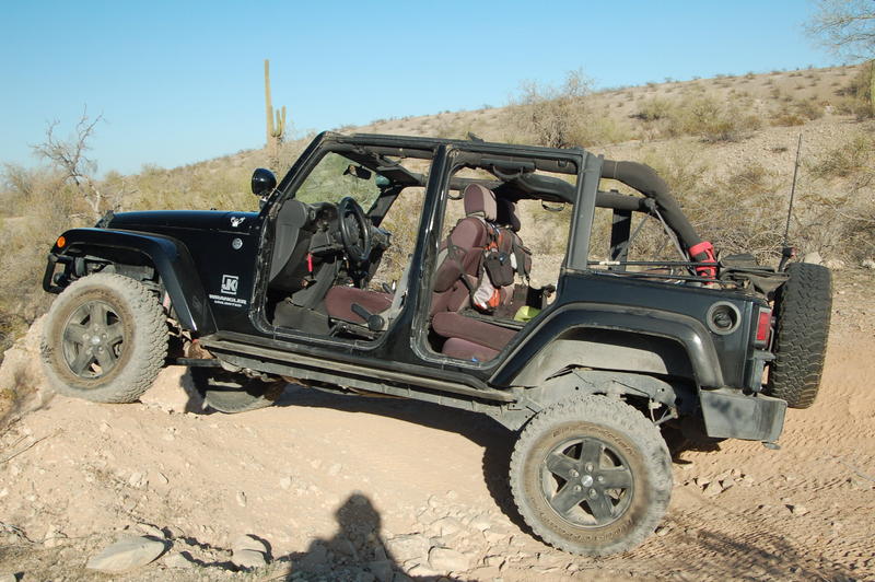

I have the 3.5" lift and i would def choose that over the 3.25 lift as the 3.5" comes with new control arms to keep your caster angle correct. So far i've had no issues with the DS boot tearing, but then i also won't disconnect the sway bar to be safe
if you do go with that kit i suggest you get an adjustable trackbar and not use the drop pitman arm (which can cause additional stress to the sector shaft/steering pump) or the front trackbar relocation bracket
heres what it looks like with stock rubi tires
Edit: Dont forget to PM the Rough_Country Rep on here for a much better deal than whats on thier website!

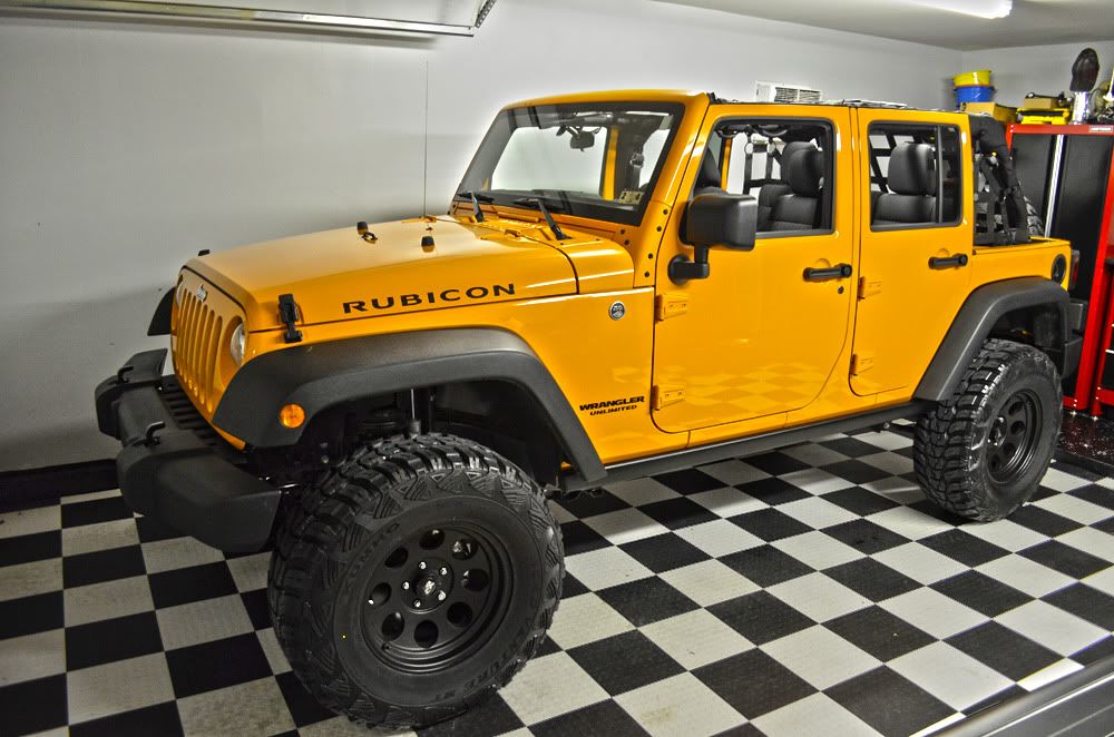

I installed the 3.5" a few days after I got the Rubicon. The street manners are great! The ride is actually softer than the stock Rubicon setup. I wouldn't mind if the springs were just a bit stiffer. I have only had my JEEP for two weeks, so haven't been able to test it off road.
I will prob. replace the front drive shaft soon to be on the safe side.
