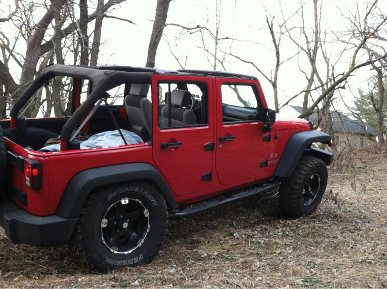

  #24
Wranglin07x's Avatar
Posts: 96
From: Ephrata, PA
I went for the 3.25 inch lift. Its a good lift for the cost, granted i think the shocks could be more soft. Can be a little harsh on bumpy roads.. but other then that ive had no complaints
