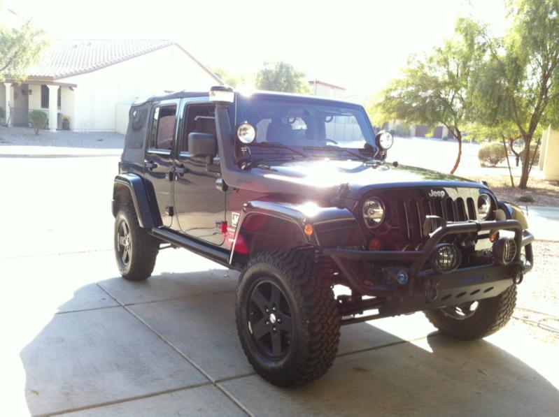

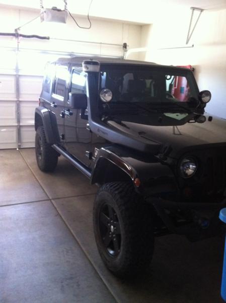

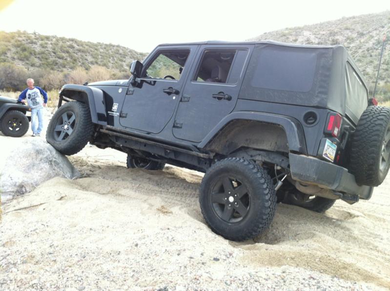

I've had that lift for over a year now and IMO its a decent lift for the price (PM Rough_Country on here for a better deal than the site) I would highly recommend using an adj trackbar instead of the drop pitman arm and trackbar bracket it comes with, handling will be much better. The shocks are a little rough, but the lift does have a lifetime warranty and ive been told they will replace springs that start to sag. If you have a budget jeep like me you get a decent amount of lift for the price.
One thing with running a lift this big is that if you disconnect the front sway bars the driveshaft boot may tear on the transmission pan, so either dont disco or get a new DS

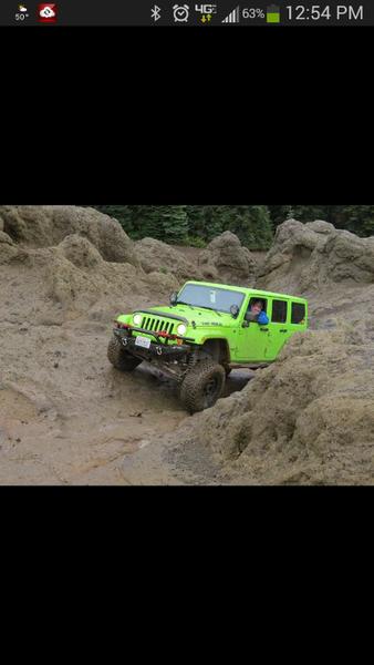

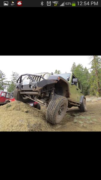

Mine gecko and my bros commando flexing a little

Can you post more pics of your rigs please.
