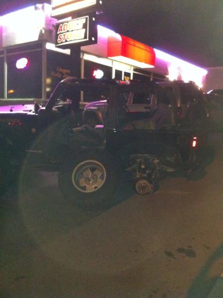

Sooooo...JUST got my nitto mud grapplers Monday. Last night, the spacers sheared my studs from the wheel hub and my left rear tire went bouncing across the street downtown. Anybody else have this happen to them? rough country spacers are evidently bad???

nothing else was hurt on your axle?

Looks like it was a bent rotor, broken studs, and MAYBE, hopefully not, bent shock bracket. It was makin a noise so I pulled over and right as I hit the bump pulling into the gas station it dropped and slid maybe 3 feet and i watched the tire make it all the way across the busy intersection. Kinda funny actually.

Did you locktight them on, have you been re-checking the torque after wheeling and or every tire rotation?

Haha I kinda had to laugh at myself

Loctite yes, they've been on for like 2 days.

Did you remove the assembly clips before mounting the spacers?

Supposed to recheck them at 50 miles. Anyhow, that sucks , glad your ok, coulda been alot worse.
This is one reason I went spidertrax, more$$ but a extremely good track record.
Seems like it mausta lossened up being as that it sheared off the hub.
