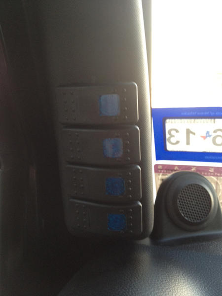

Can you guys post up a pic of this setup. Especially with the OTRATTW switches.
Here is my RR pillar pod with 4 OTRATTW switches.
