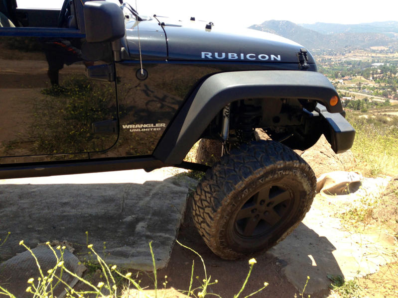

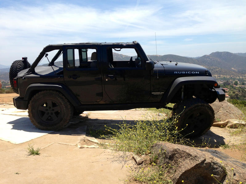

Added a Teraflex 2.5 inch coil lift. I have longer sway bar links and take it offroading. The Sway bar disconnected with out a problem, but it's not reconnecting anymore. I've drive about 20 miles already and the light just keeps flashing... Any ideas?

I was messing around with the new suspension testing out the flex. And then it just never reconnected. I've driven about 40 miles now and still no luck
