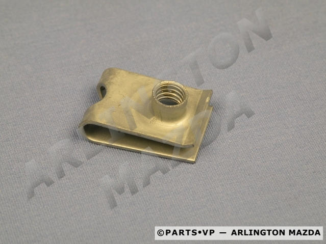

Yeah, the holes in the body underneath just take the clips that slide into the hole, with the threaded nut up top, inside the body. This is not the exact one, but it's the style thats used:

Oh well, I somehow missed the whole "got these installed tonight" post, so I guess this info was not needed...LOL.
