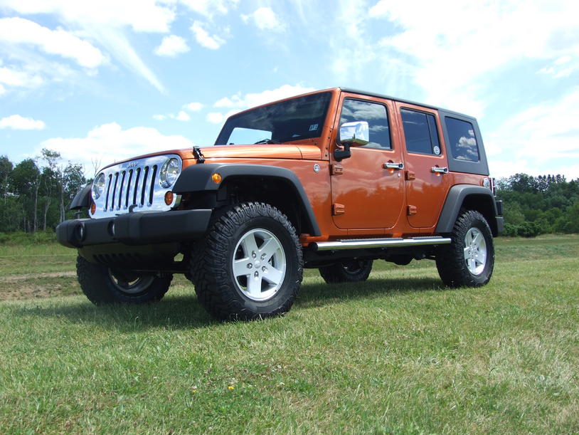

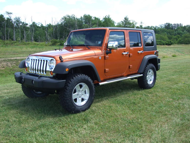

Just added Teraflex Leveling Kit, 2" in front, 1" in rear with 285/70/17 Cooper STT. NO Spacers. I love the attitude adjustment. With 2 different GPS units on board, my MPH are exactly correct with these tires. My steering wheel did not need adjusted. I notice no power loss. Just a good looking mod. The height is just right for what I do. I'm not crawling rocks or going mudding just daily use. I just wanted it to look like a jeep should. Tires barely make a noise on the road also.
