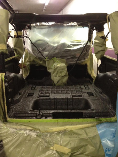

I used liner extreme on the tub of my jeep... It's looks amazing an I just hose it off after wheeling trips !

Originally Posted by Willis19
Attachment 381165
Great Idea!
