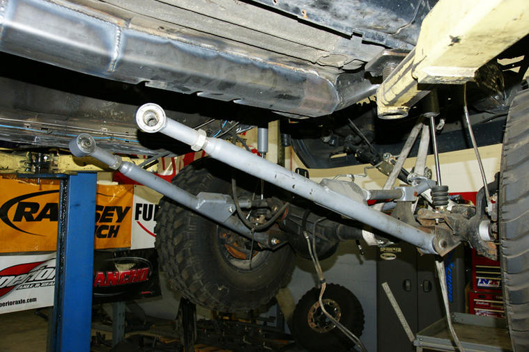

unfortunately, this is not necessarly a bushing issue but rather, it's an issue caused by radius arms.
radius arms are great on vehicles like desert race trucks where you have big vertical travel of the axle. however, by it's design, radius arms are in a state of bind the moment you try to force them to articulate. if you were to disconnect the radius arms at the frame, they would stand straight out like a diving board like this...
in fact, if you were to grab each end of the radius arms and try to push them in opposite directions, you would find it very difficult to do as your axle holds them firmly in place. think of your sway bar - not the links but the actual sway bar itself - it is basically a torsion bar that wraps around with 2 arms that the links are attached to. that's essentially what your front axle and radius arms are like only, your axle is no torsion bar and it will not twist. there are companies that have made axles that allow for this kind of rotation but without it, you have bind. using bigger bushings will help prevent them from failing prematurely but, regardless of how big they are or where they are made, flexing your jeep will cause them to fail again.

I understand the Inherent Issue with them and why the bushing failed because of bind.
I might Just Cut off the upper mount and run the lowers only on my wires Jeep.
I wish i would of purchased a 4 link kit now but everything is a learning experience.
a lot of people have done something similar to this in the past - kill the upper links in favor of real upper arms and run the lowers as is.
