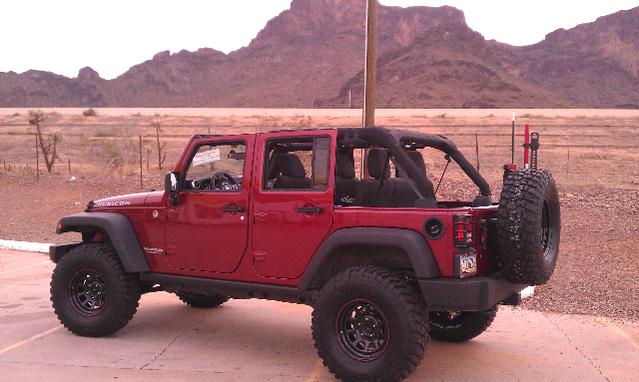

Anyone have any pics? From the pictures, the lift looks like you could run 37's with flat fenders easily....

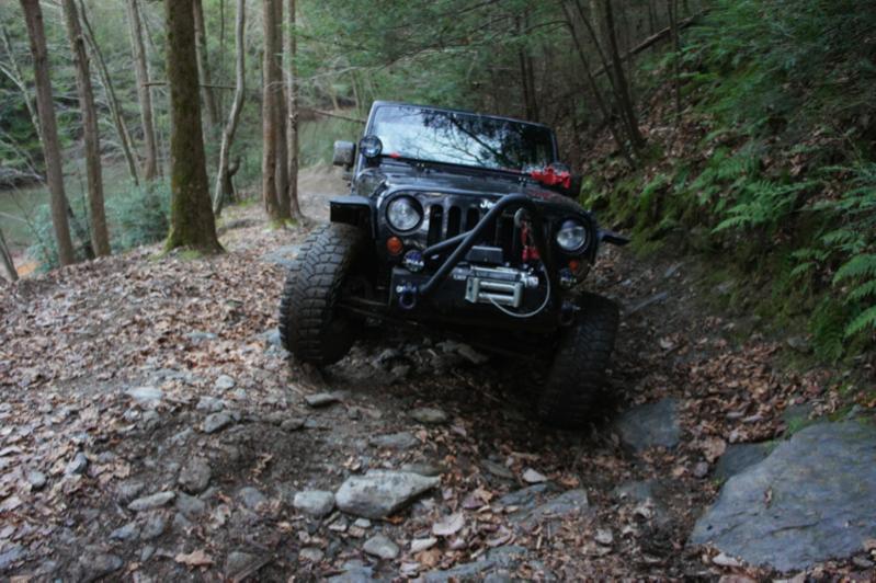

Here is a couple. One shows some flex of the 3.25 advanced lift

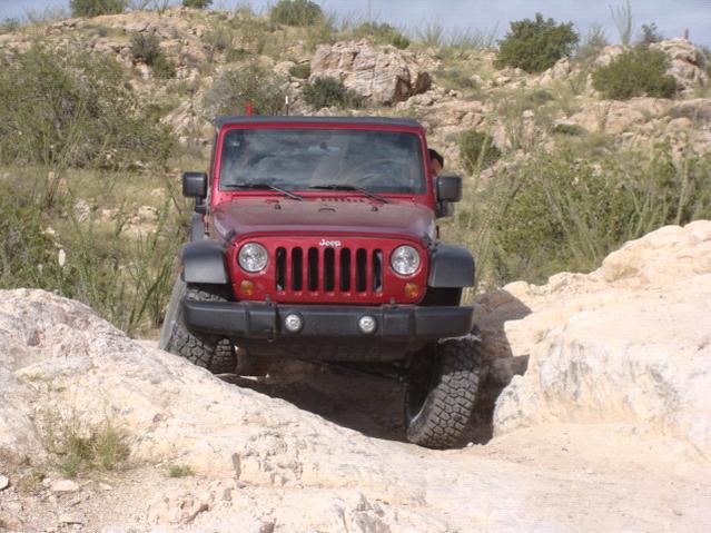

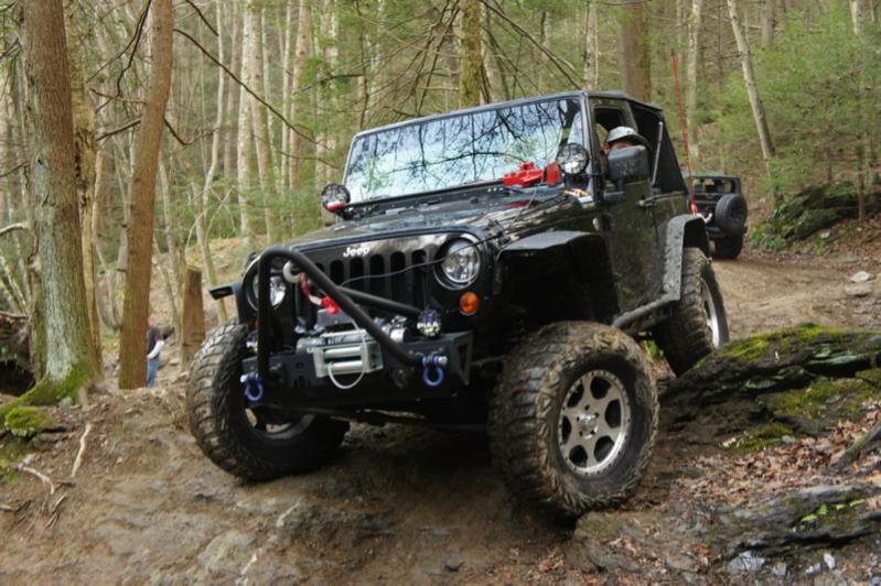

I have a rustys 3.25 on mine and love it ....only issues I've had is I crushed back of steering stablizer and didn't relize it started having death wobble issues when hitting bumps ...replaced all shocks with bilstein 5100 and replaced and remounted in right place the steering stablizer and back to normal with a even better ride upgrading shocks .....veryy good flex and awesome kit on and offroad highly recommend !!
