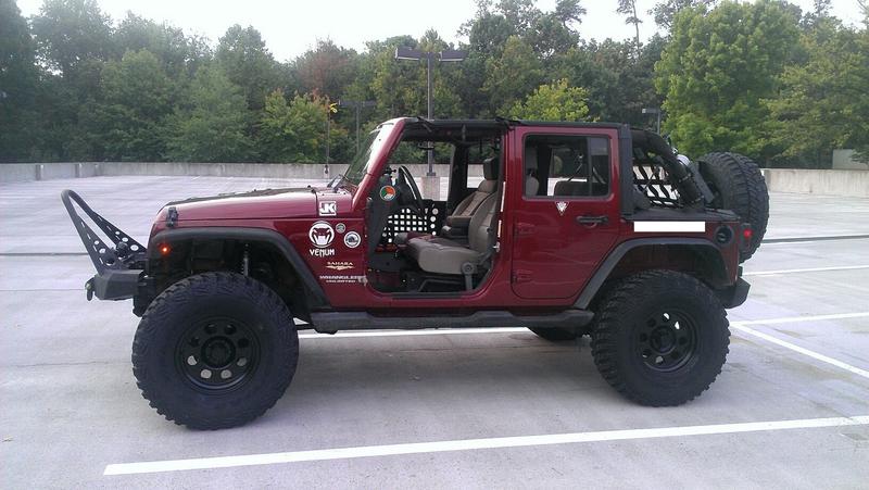

When the bushings went on the front LCA's and the track bar, I took that opportunity to 'upgrade' I didn't want to have to futz around with pressing out bushings and all that crap. I must say, the teraflex monster TB is just that, a monster. The Basic kit gets you where you want to be and then you have the time, >30k miles, to figure out if you want to go in a different direction or change out good parts for fantastic parts as the budget allows.
Rusty's basic kit is a good kit to get you on the road, and off, while being able to run 35's without a problem. after trimming my fender flares on the back and getting poison spyder fenders for the front, i am now running 37's without issue.
I really should have measured but I think it was about 4" and now maybe 3.5ish.
This picture was taken late August 2012 and the lift when on November of 2010. I think it has held up well.
