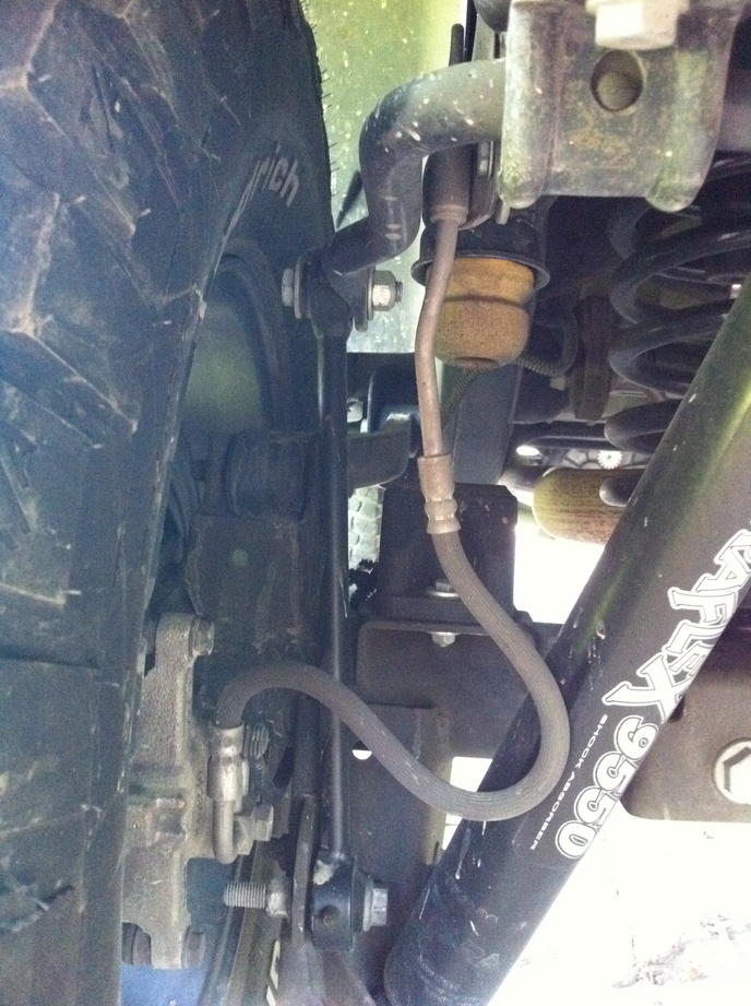

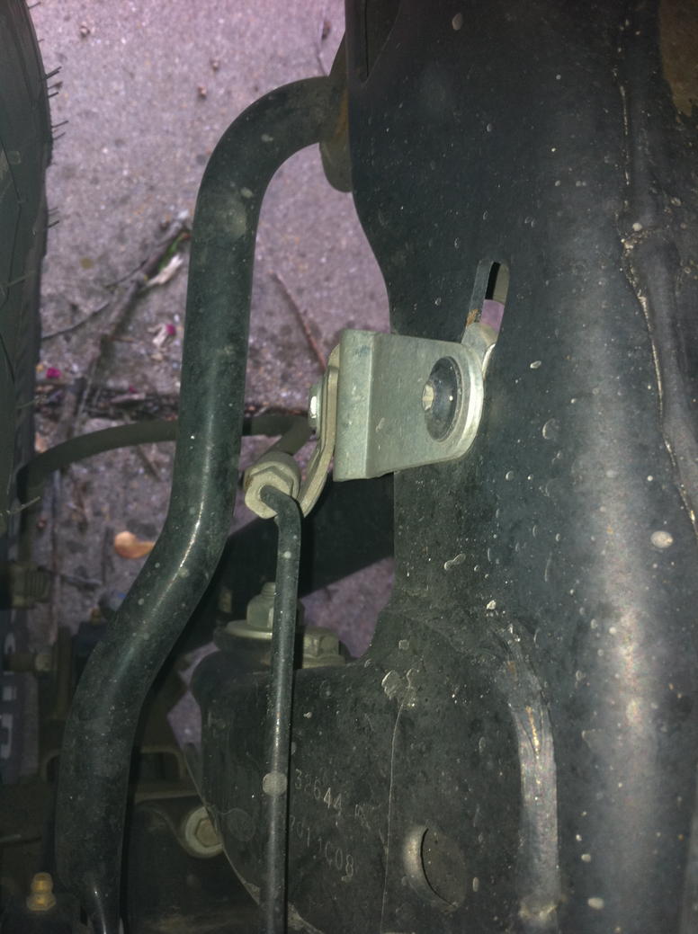

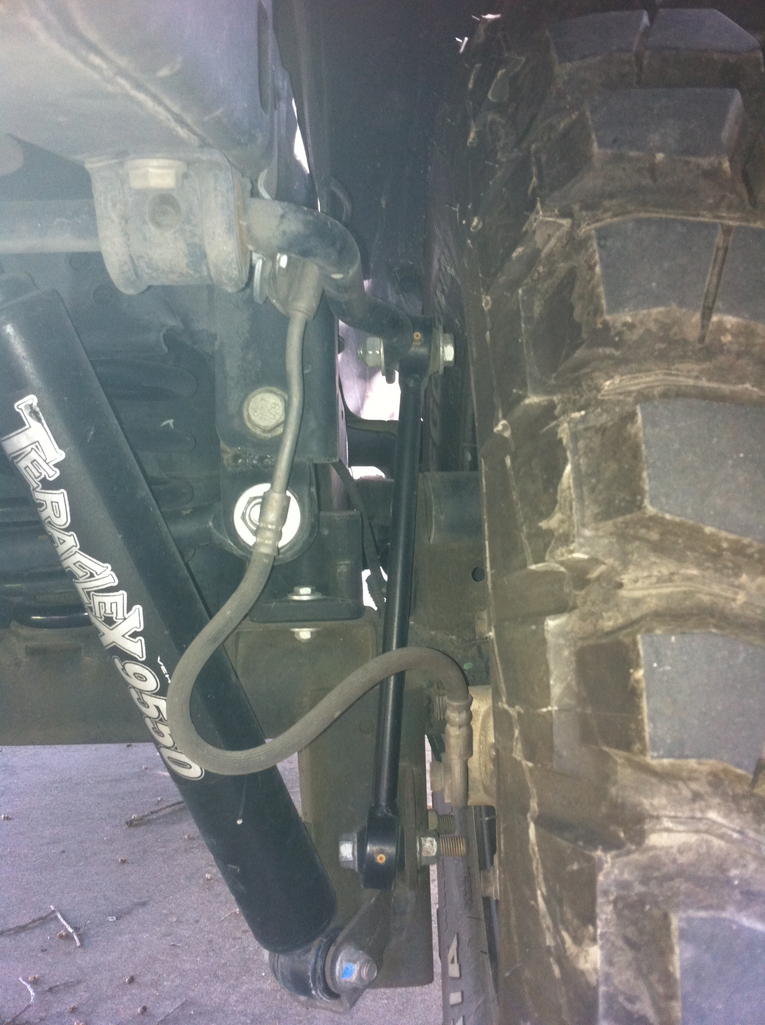

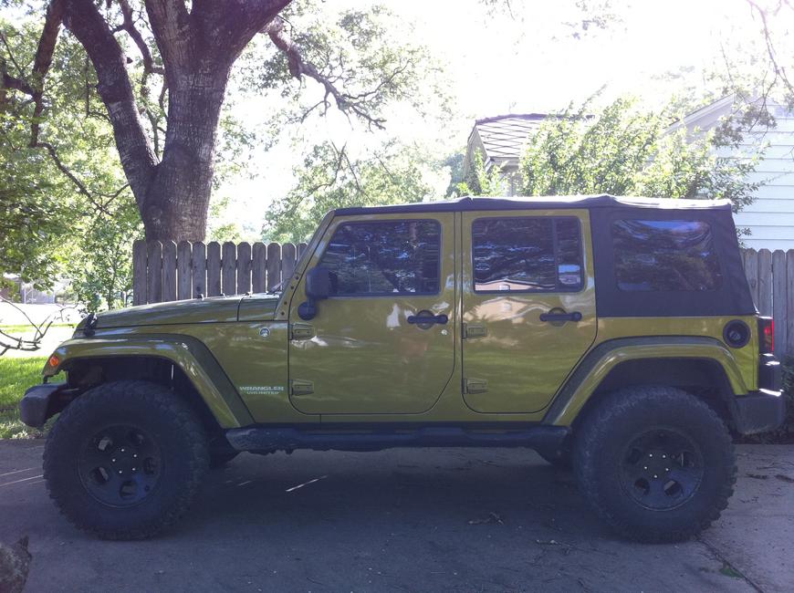

Here are pictures I just took: a profile with the rake shown, not the best quality and I think the concrete might not be level. a picture of the brake line bracket from above, a pic of the left rear and a pic of the right rear. These are to show how the Brake line bracket and sway bar connectors were installed.
Checked the front to see if it had those spring spacers and it does, but it seems that on the coil the bottom two levels are smashed together....could this be causing the sag?

Well your swaybar links are installed wrong and so are the rear brake line extensions. The swaybar links are to be installed on the inside both top and bottom or on the outside if you have clearance. The rear brakeline brackets are flipped around the wrong way. Also it looks like the installer didn't put in the bolt that goe's through the rear factory trackbar bracket and into the TeraFlex track bar bracket. Looks like there's some welds on it? Who ever is your installer failed to installed your kit correctly, I would take your JK back to them and get them to fix it.
So suggestions? Take it back to them, what would do I say? Also don't believe I got any kind of warranty of work in writing.
And a possible answer to the weld...they told me that it would be stronger than that bolt, is there a possible fix to this?? As I have previously stated I am a total novice at anything mechanical, and learning as I go. I feel like they took me for one here.
Really feeling sick to my stomach right now. This is all fixable correct?
