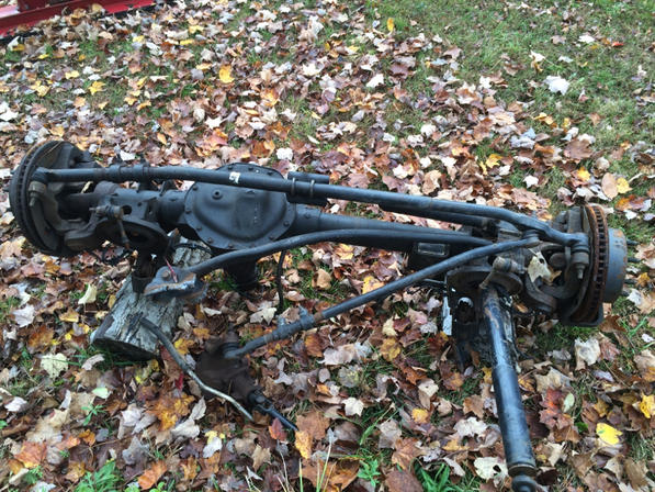

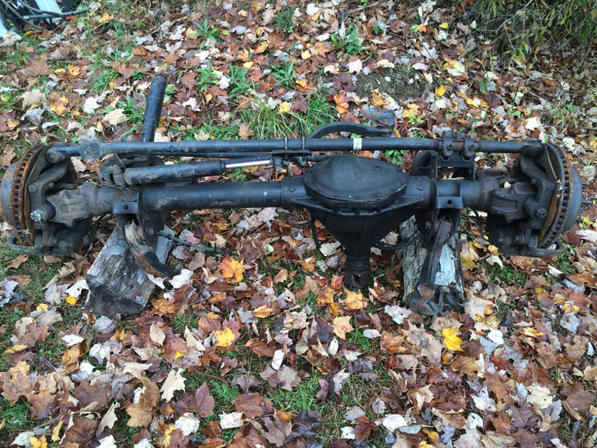

I stumbled upon front and rear axles out of an 08 3500 dodge today and was almost given them. This could get interesting. Click image for larger version

Really curious to see how you use a passenger side front axle. What's the plan?
It's not, that pic is looking at the bottom of the axle. Notice the lower control arm bracket and the shock in the pic.

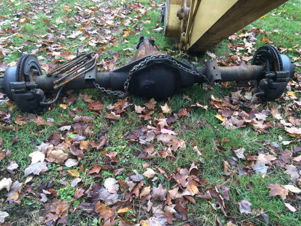

He's a pic looking from the top

Originally Posted by jrod250
It's not, the pic is look at the bottom of the axle. Notice the lower control arm bracket and the shock in the pic.
Yep, see that now. Should be interesting. Can't say I recall a build using Dodge axles.
