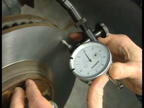

Jack up the front end, one side at a time, take off the wheel, put a runout gauge on it and give the hub/rotor a spin and see what the indicator tells you. Then put that wheel back on, and repeat on the other side. Process of elimination. Don't swap parts for no reason.
