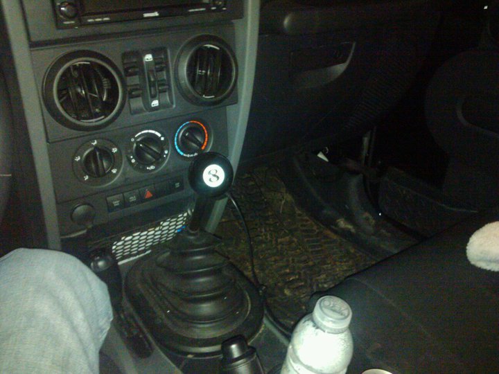

I put a towel around the shifter and then used the instructions above. I used a crescent wrench, smacked it a few times and it pulled right off. It helps to place the shifter in 2nd gear for a better angle...

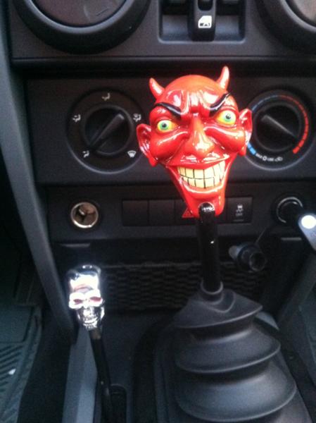

Don't think anyone mentioned the sleve that the knob basically sits in with the cap at the bottom which hooks onto the knob to hold the sleve on. Confusing so here are a couple pics that might clarify for some. The descriptions here helped me get the bugger off. After getting the sleve down the shaft, I used a 5/8 open end with a rubber mallet to pop the knob off. Thanks to all earlier replys. You guys helped. My project was necessary because the original plastic bezel had broken at all the plastic connections and Jeep has none in existence to replace the broken one so I got a Drake OffRoad billet bezel. Worked like a charm!!
