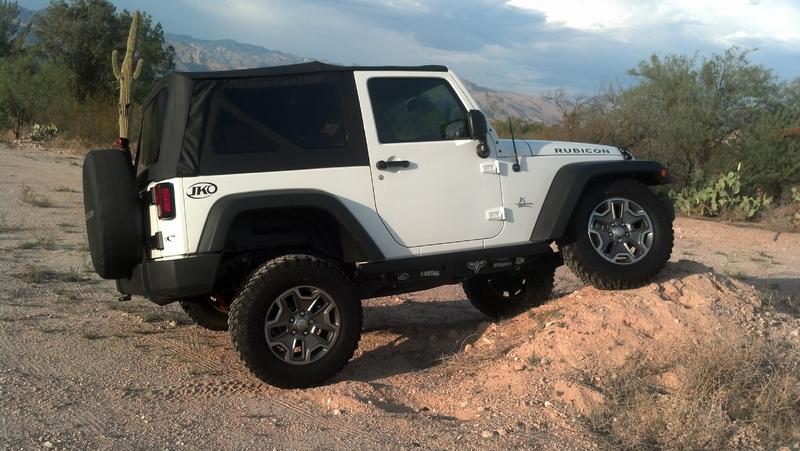

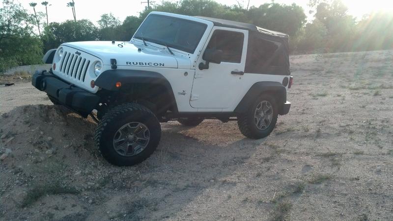

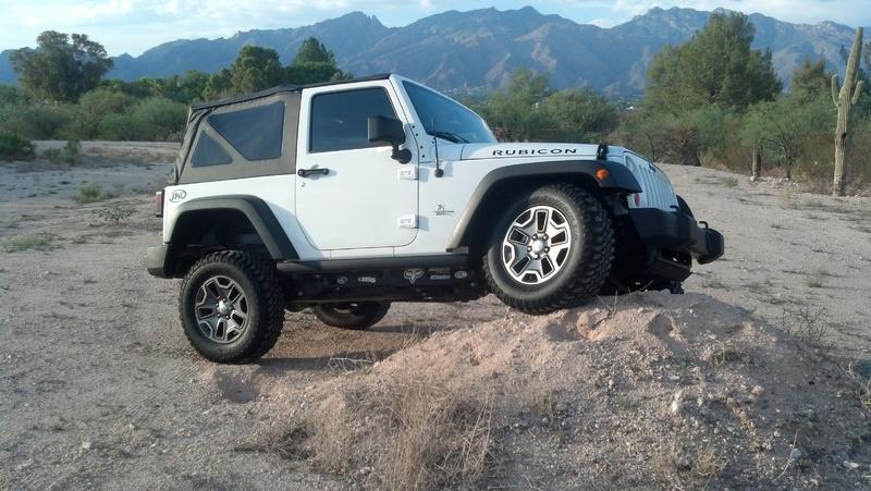

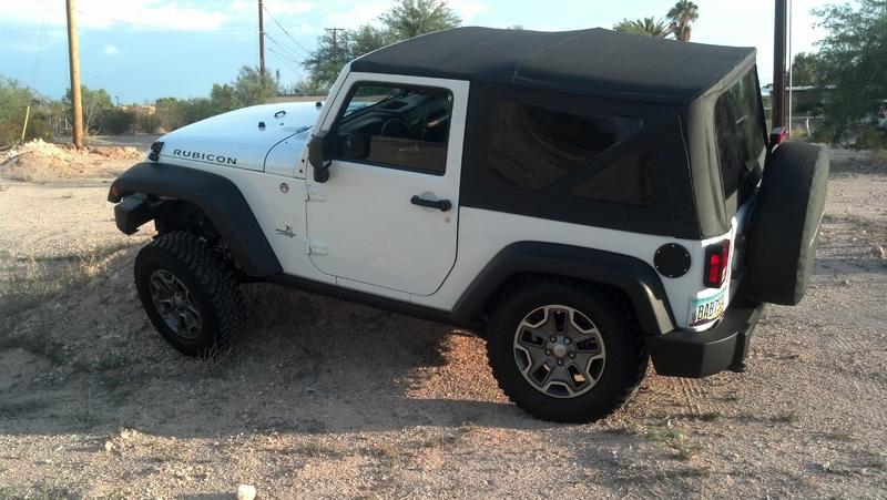

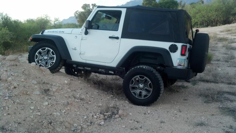

Here is my quandary... I am looking to put shocks on my 2013 2Dr Rubicon. I have replaced the stock springs and shocks with ones from a 10th anniversary 4dr and it raised it, but the ride is too stiff.
I do use my Jeep for daily driving.When I do go wheeling, 3 - 4 times a month, I do get into some pretty rocky stuff. I live in Tucson, AZ and want the best of both world here. I want a shock that will give a good ride, but I also want durability and performance while crawling and off road.
I have $1400 to spend on this and I really want to do it right the first time. I am going to upgrade to a 3.5" lift when I do my tires... going to go with 305.70.R17... I am still up in the air about the lift as well... Want something with some flex and a good road ride as well.
I will want something buff, maybe more then what I need because I roll like that.
Can I please get some advise from you guys.
Respect,
Here is my Jeep now................
