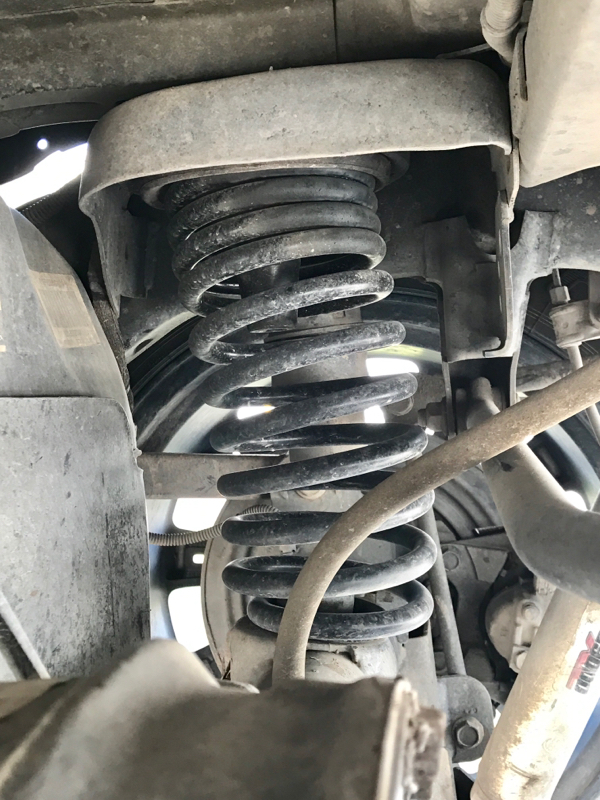

So I agree with waiting and not wasting more money. With that being said should I invest in some short arms for the time being and just sell them later?
I'm assuming that because of my pinion angle this is why my rear springs look like this?

Wouldn't spring perch location also be the culprit? If you JK is lifted, and you pinion angle set properly, it would seem to me that the spring perch would then be in the wrong spot. This is why they sell correction wedges.
I have the wedges myself, and it's still not where I want them to be. Now that I have a good welder and am taking classes, I will likely look at cutting off my stock perches and welding on Artec or Barnes 4WD replacements this year. Now I need a plasma cutter.

Pinion correction with adjustable arms will cause bow as well. To properly do it so you get the coils straight would be to cut off the axle perch and move it back and level then weld it back on. You can add adjustable arms and put the axle back in the center of the wheel well and then cut and rotate the coil perches so they sit level at ride height.

Like they had said correction wedges will only give you so much, but the best way to do it is to cut them off and weld a new set on flat!

Sounds like I have some work to do! I guess I should buy the adjustable arms then cut and re-weld to get me back centered. I will also need read adjustable track bar.
