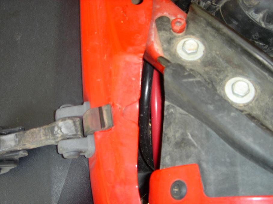

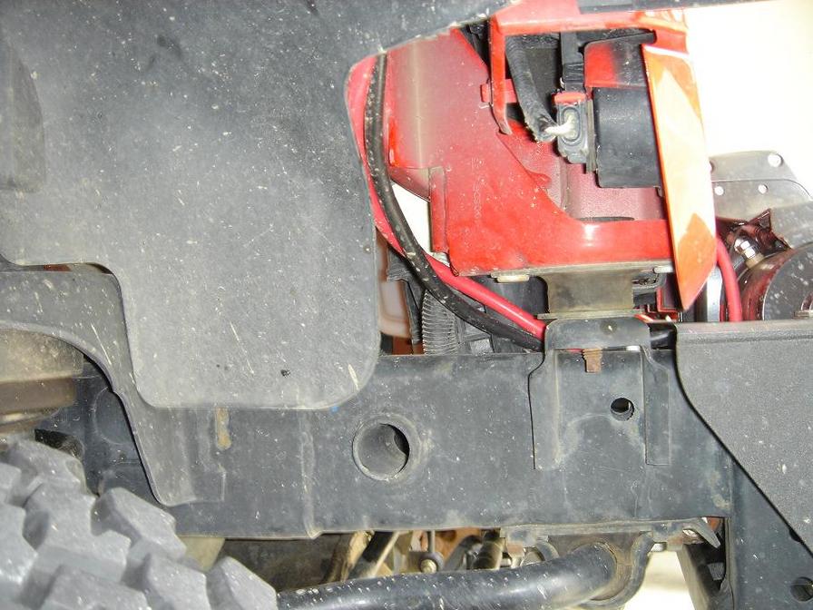

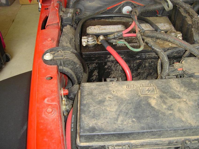

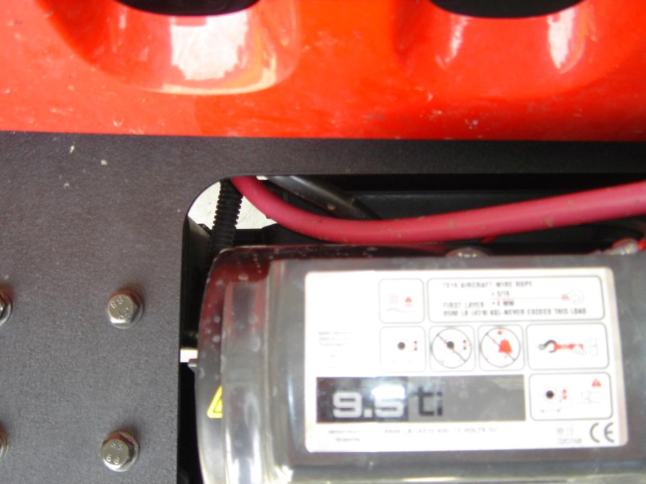

Hope this helps...

your welcome. I know the one pic of the wheelwell looks kinda like the wires hang out but they don't. Nothings pinched or kinked either. everything is relaxed and loose.
