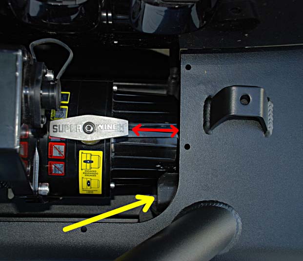

I really thought the bumper would be tall enough that the winch would slide under the bumper. Was it hitting the bumper itself or the piece of the frame the yellow arrow it pointing to?

Jim, you nailed it--the yellow arrow. I sent a PM to Nick saying I should be able to send pics tomorrow.
