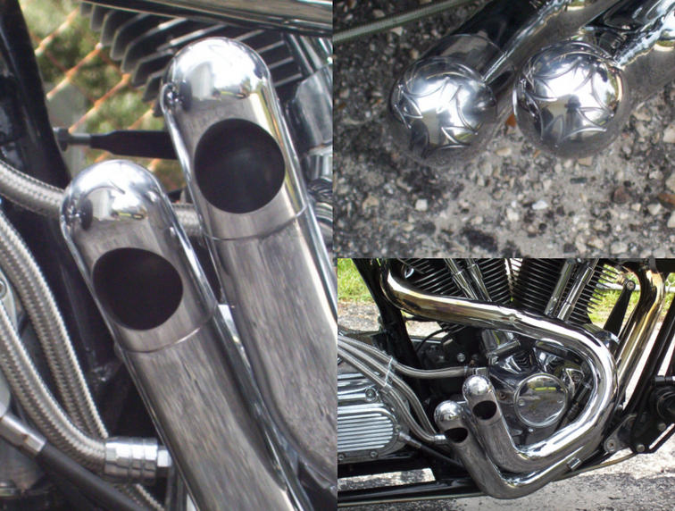

ok so i just did a streight true magnaflow muffler and i think it sound to loud inside. it sound deep loud and go right inside my ear. i asked my girlfriend to drive the jeep in front of me so i can hear how it sound from the exterior and from some possible police ear... and i was extremely iimpresed how low the sound was from outside !! i was looking at some possibility to lower the sound from inside. was thinking about a exhaust tip made to lower the realy deep shaking sound. i tought about a closed end tip with some ... steel wool at the end to somewhat lower the noise.i found that ( see image ). its on a chopper i know but i saw some exhaust tip like that before for trucks. anyway what do you think i can do to lower the sound. o and one last thing ... the sound is maby 20-30% lower when the motor muffler is hot. that is cool but is it gona keep geting lower with time? i have no carpet and i remeved the insulated material at the back , and have not my drain plug right now. ( planing to do bed liner soon!! )

Can you take a pic of the install? Where did you put the muffler? How far back? Is it a two door or four door? The farther back you put it, the less interior noise you have. We put mine as far back as humanly possible and my interior noise level is very tolerable. There are tips like you spaek of for automotive use, but most of them are huge in diameter and would pose a risk for getting crushed on the trail.
