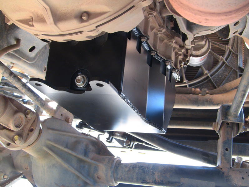

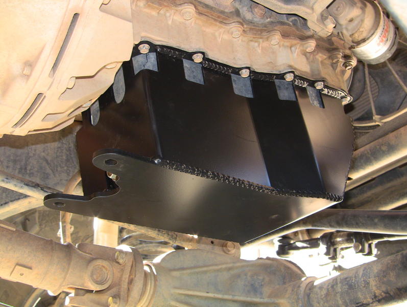

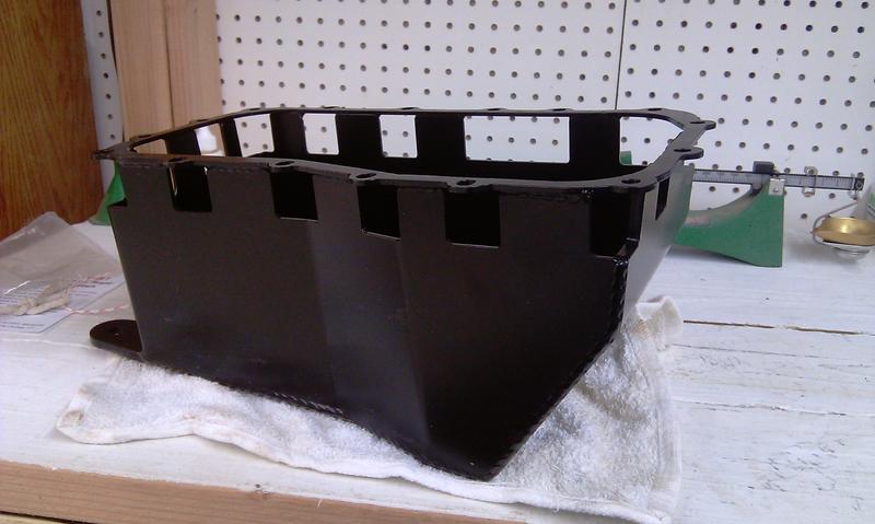

Ive got an 08 and i put the EVO oil pan skid. Ive now got the tranny skid on it as well. Here is a pic of just the oil pan skid.
