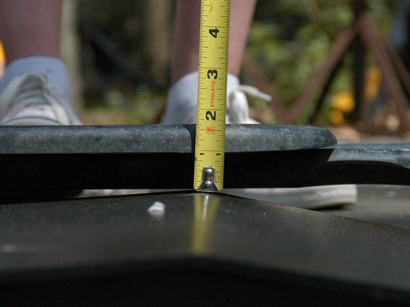

i don't know who's feeding you this BS but unless you're replacing the factory transmission cross member with one that sits higher and relocating your exhaust cross over up 1.5" and replacing your gas tank with one that is physically shorter, there is no way you are going to gain 1.5" of additional clearance.
Hey WOL, as I don't actually own it, I can't say first hand. I am just going by a review. So I guess I could be incorrect but it makes sense when I see it. Click image for larger version
The clearance gains are limited to the area where the stock skids were located

Originally Posted by Cameron1022
Hey WOL, as I don't actually own it, I can't say first hand. I am just going by a review. So I guess I could be incorrect but it makes sense when I see it. Attachment 102337
got it - the review is taking into account the thickness of the factory tranny skid and what you will have if you remove it or replace it with something thinner. for those with a 6-speed, this claim would not apply at all.
