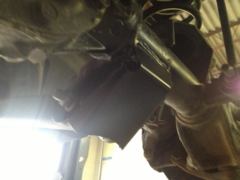

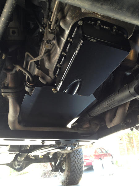

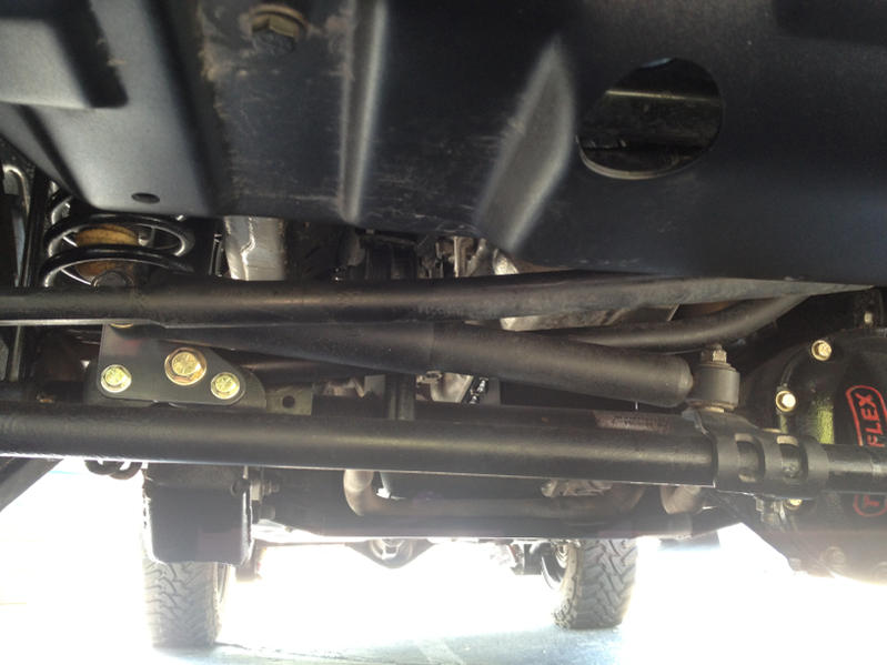

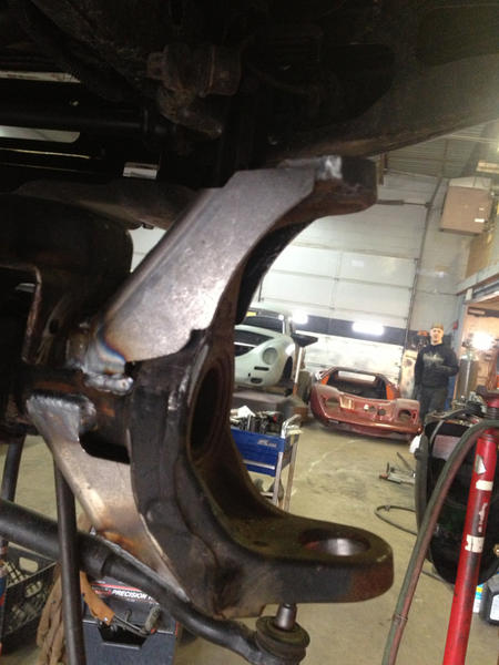

You've got the right thought process! I installed mine after my first 4wheel trip and gouged my whole undercarriage (Rausch Creek). I went all EVO on my 2012 JKU. EVO Protek Skid System, EVO F&R Lower Control Arm Skids, and EVO C Gussets.
