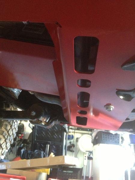

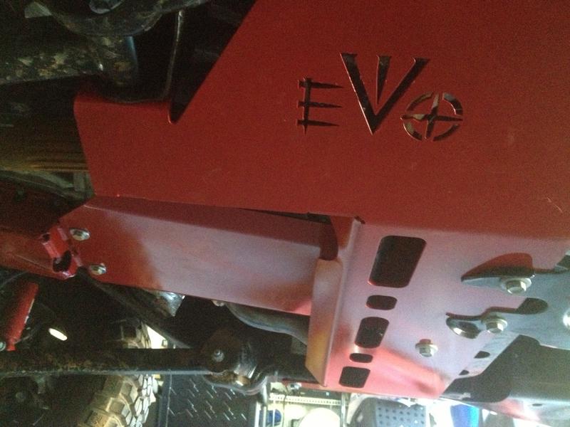

I just installed the EVO skids on my 2013 JKU. Took about two hours. I picked the EVOs for two reasons. One, I was able to go down to Fullerton and pick them up (very nice people, BTW), saving on shipping and two, I was impressed by the step-by-step installation guide and review over at Project JK.
Since Project JK did their piece it appears that EVO has added vents (for lack of a better term) in the area around the crossover pipe, as you can see in the pics below.
Attachment 506019Attachment 506020
I have the original EVO skid plate kit of sure I'd like those vent holes...
i was on a Jeep Jamboree a couple weeks ago and someone had a rubicon with skid plates with gaps and a strong tree limb found that gap and punctured his transmission and he lost all his fluid and it took two jeeps with rescue his Jeep off the mountain

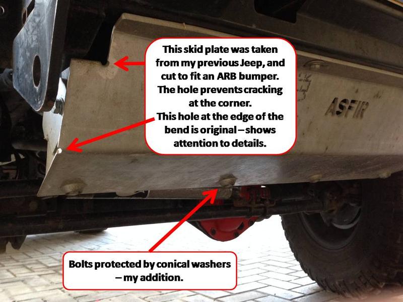

For some odd reason, the Asfir skid plates are not very familiar in the US.
Made of tough & thick aluminium alloy. I've seen them prove themselves on a few Jeeps, and have them on mine.
Asfir are approved by a few armies, and supply them with skids made of the same material.
Link -- JK Wrangler

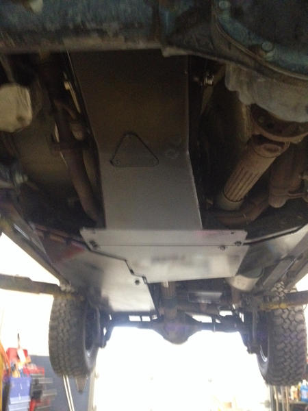

Got them on finally
I can't wait to try these out

How about some truth..... all these systems are nearly identical. If I were in the market, I'd be looking at price.
Also... forget the fuel skid. All you are doing is adding unnecessary weight.

Originally Posted by Gieringer11
Attachment 515049
Have these guys corrected the oil pan skid.... last one I saw was an abortion waiting to happen.
