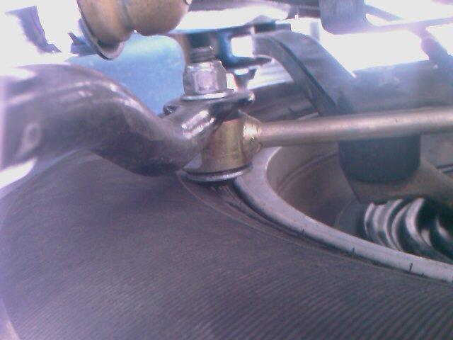

i just put the 4" skyjacker nitro kit on my JK 4 door! it was a pain, my rear swaybar end links r cutting in to my tires! Skyjacker think i did it wrong there to way to put it on i have it on the outside! if i put it the other way the bolt sticking out will kill tires, can anyone help Me pls thanks

ok here a pic

yep its installed wrong. Mount it on the other side of the swaybar.

yea you mounted wrong. move it to the inside of the sway bar and other side of axle

looking at the pic, what back spacing do you have on the wheel? looks like 6 back spacing. i have 3.5 back spacing my caliper dust sheild is even with the rim, you can switch to the inside, but tire will be close to sway bar.
