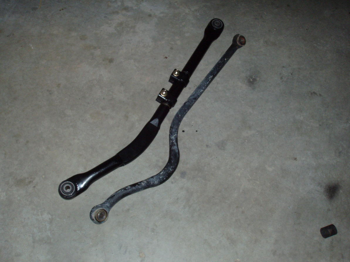

You should scrap that bracket and get the Teraflex adjustable trackbar the bracket that skyjacker bracket will place a lot more stress on the factory welds at a angle that it wasn't designed to hold. The Teraflex adjustable Trackbar is designed to utilize the stock location without putting any unwanted stress on the stock bracket. Plus it is twice the thickness of the stock track bar..

Yep! This is exactly what I did. I love my Skyjacker lift, but that bracket is a POS!! My bracket kept working itself loose, and causing death wobble.

I took both of my brackets off yesterday and installed JKS adjustable trac bars. They seem to be a lot stronger (thicker) than stock. My Jeep was also not centered (by about an inch). i have within 1/16-1/8 now. I can live with that.
