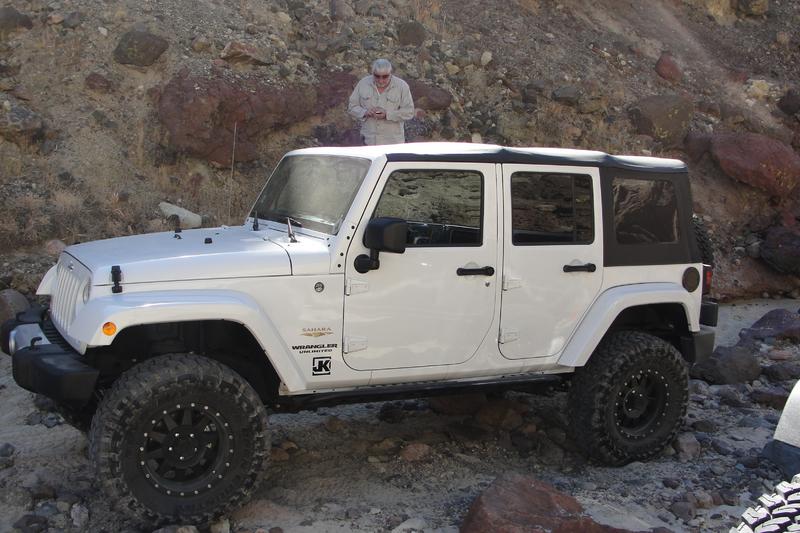

LOD sliders, Evo sliders both attach to the frame. I have the LOD which have a nice step for getting in and out.
