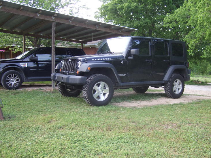

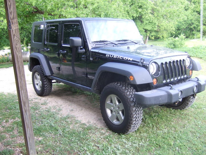

I have a 2 1/2 in rough country spacer lift that comes with everything you need to relocate brake lines. It was $135 at www.roughcountry.com. super easy to install. this pic is before i put on the 35's.
