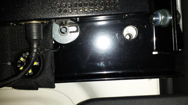

I removed the front footman loop as the directions state. If you are running a soft top, the console comes with one that you can install as needed. I also removed the front, middle L latch on the hardtop and I drilled a hole in the console plate directly underneath the hole left from the removed L latch bolt.
I purchased a bolt to fit into the threaded hole in the freedom panel.
I then screwed this new bolt, with a washer, up through the concole and into the freedom panel. This pulls the front of the freedom panels down against the console just enough to make up for the missing L latch.
It works great. No leaks, no wind noise, and I just need a 13mm wrench to remove the freedom panel. Another option I tried, was to use a short piece of threaded rod and a wing nut. This worked well also, and allows top removal without needing a wrench.
