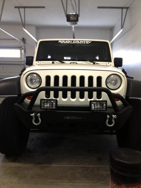

Thats what i did to mine

Factory fogs are 45w each. I use Hella at 55w each spliced into the factory fog light wiring/switch.
No problems at all.
