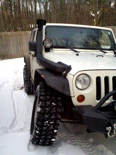

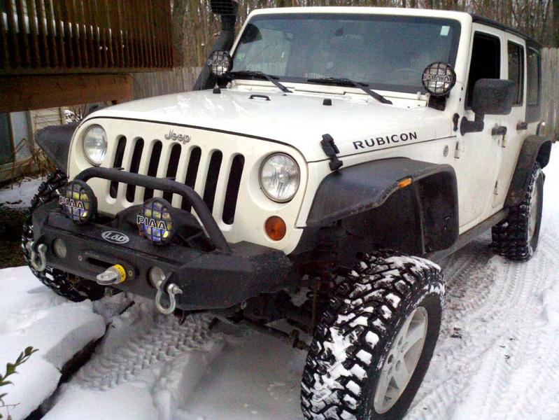

I decided on the AEV Snorkel because of the design and the fact that I would rather cut the stock hood than the JK body at anytime. My guess is that the AEV Snorkel breaths better than the other ones. Not sure if this is true or not. Anyways, I saved a lot of money by using my stock hood rather than buying the AEV hood. The AEV hood requires painting along with the cost of the hood is expensive. Oh! by the way the AEV Snorkel will work with stock fenders as well as Bushwacker Flat Fenders without any modification and even with the Gobi Rack system.

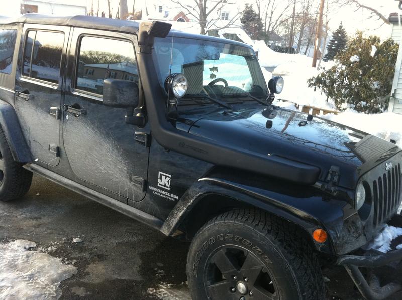

Just installed my AEV and couldn't be happier
Got it off craigslist for $100 brand new with both filters!
Also i've never used a dremel or done sheetmetal before. But once you gain the courage to cut your hood its pretty simple, just nerveracking is all.
Just make sure you paint the cut areas after so they dont rust. i used Rustoleum Bare metal primer and Rustoleum Black Rust preventive spray paint
