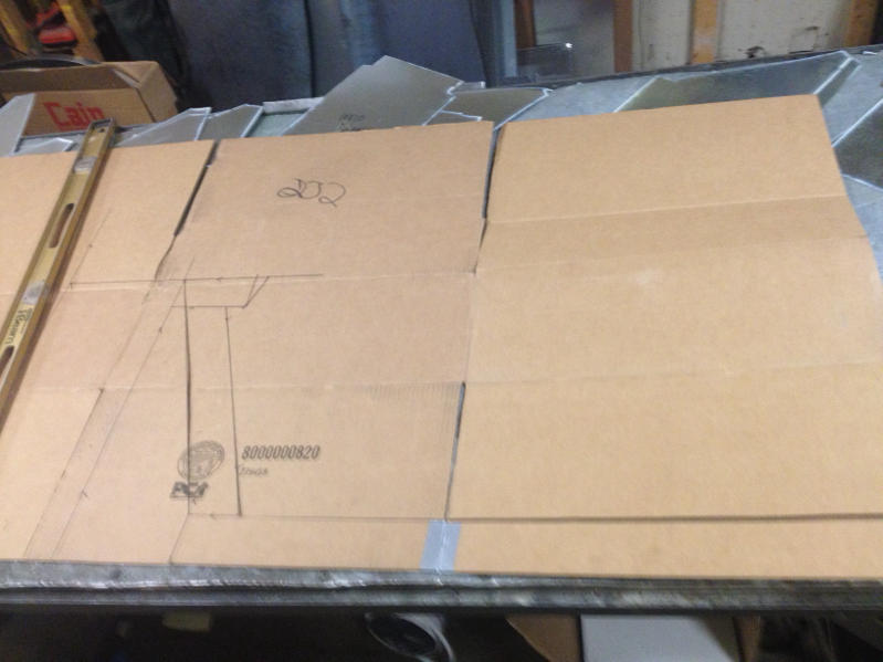

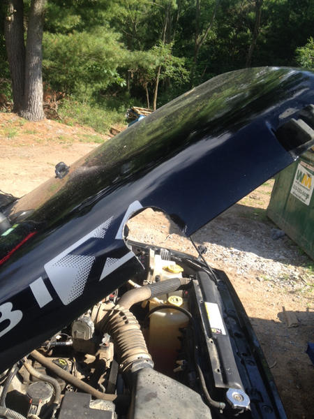

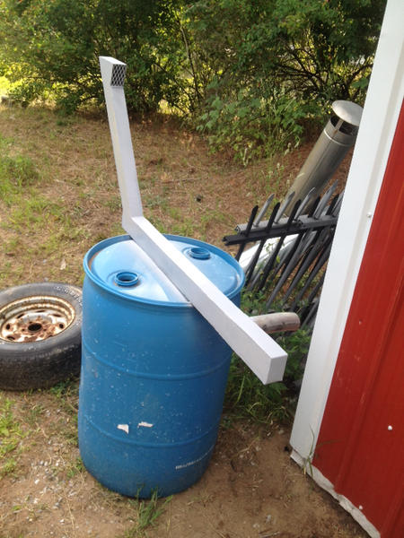

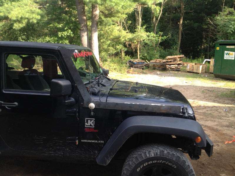

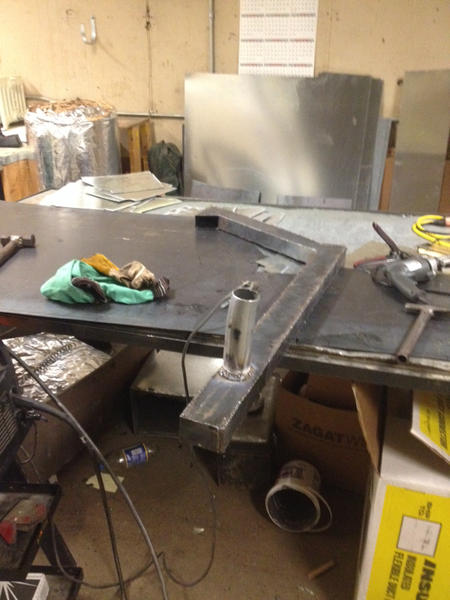

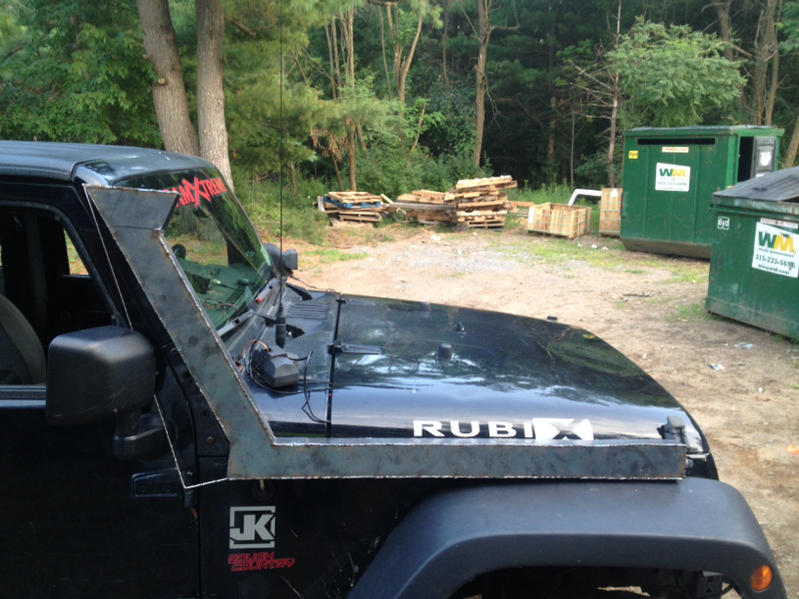

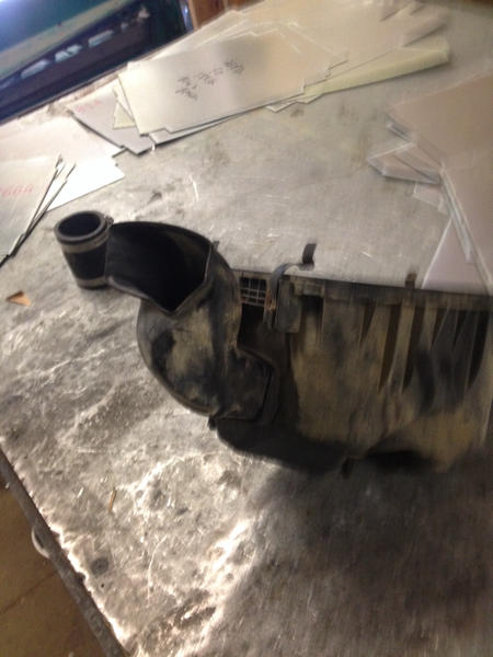

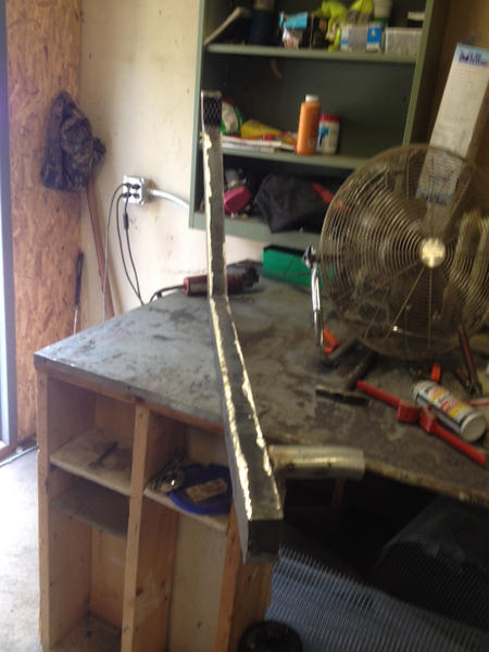

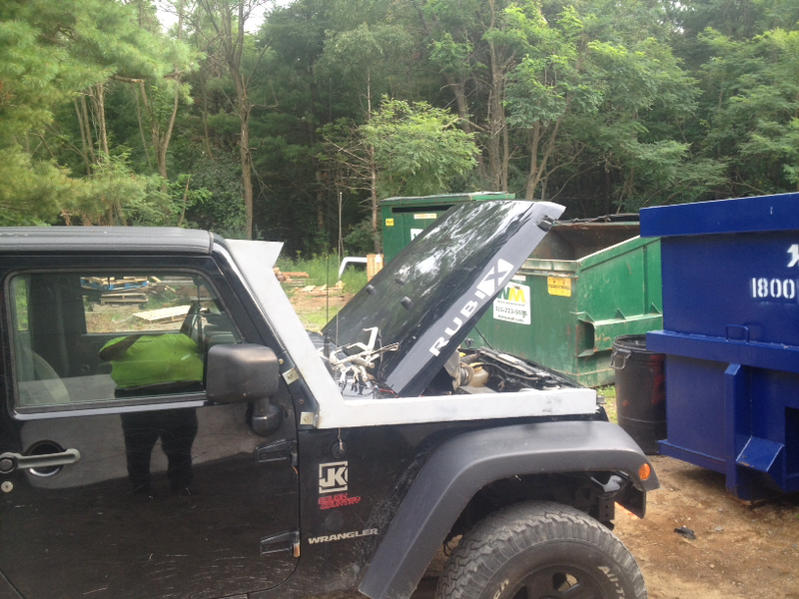

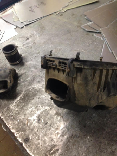

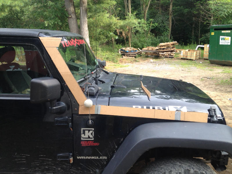

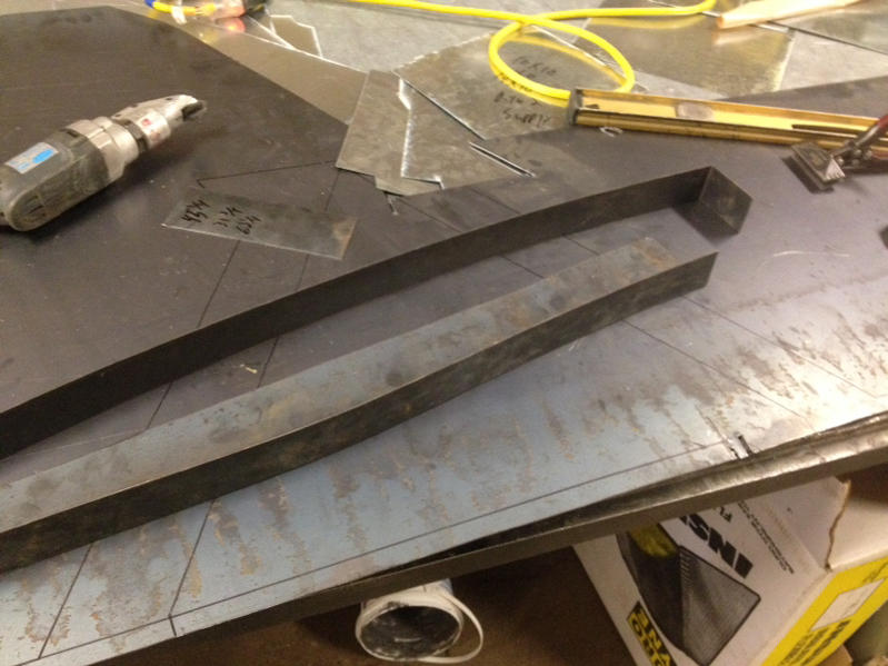

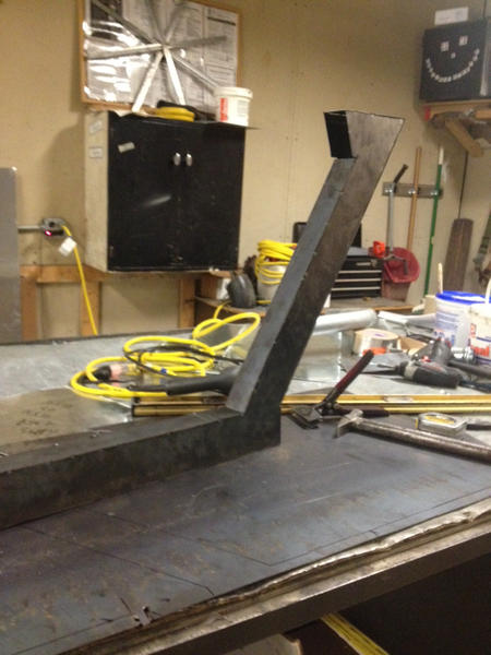

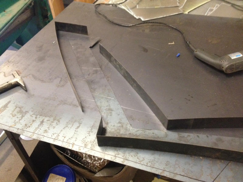

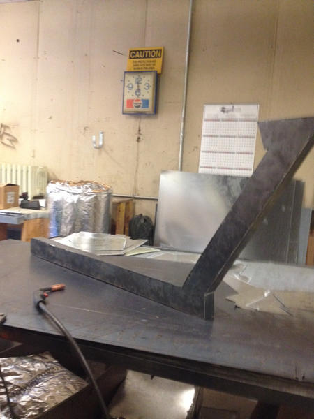

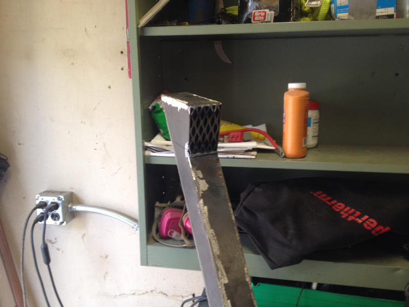

This is my snorkel build. Made of 16g steel

That's some fancy work. I do not have the talent or patience to build this so I just bought one. The only problem that I foresee is the angle of the air entrance. Most snorkels have enough angle to prevent water from entering during a rain storm. Also, I would suggest you create a way for water that enters to escape before it makes it to the air filter.

Great that your doing your own work instead of just paying for something . I think you could of taken a bit more time to make it look better but if you like it than thats all that matters.
