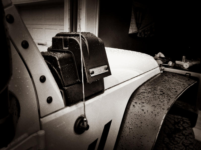

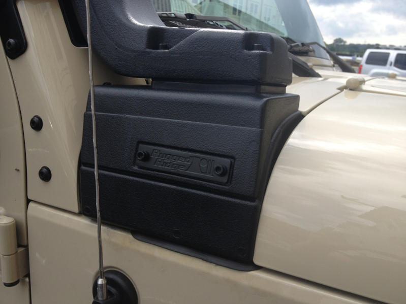

If you're set on the AEV great and a lot of people have responded. I went with the RR for this reason.
High mount= spring/summer
Low mount=fall/winter
Just a thought.

I looked in to the RR and I really liked how it was put together. I did not like how involved the installation was and the high mount would interfere with my Rigid Duallys mounted on the windshield
