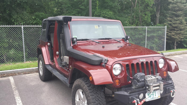

AEV installed. Ended up having a friend who does body work put it on. I was too hesitant to attempt the cut. Well worth it. I'm surprised by the quality of the plastic. It'll be awhile before I get to try it out, but at least I'll have it if I run into more unexpected water. This is very possible with all the rain we have been getting in NH.
