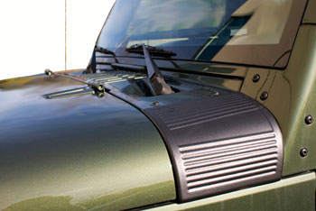

These dont look bad on mineClick image for larger version

What is that?

I believe those are the rugged ridge cowls.

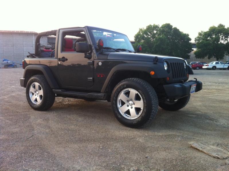

Pics please????

Here is a quick one from my cell. I'll get you the up close photos after work when I'm not goofing off with just my phone.

Here is a few photos of my cowl. I used duplicolor bedliner. Dupli color also has bedarmor which has a more textured finish and is thicker. I'd suggest the bedliner for body panels due to the easy of cleaning and the bedarmor for door guards/interior where the increased thickness helps with durability. If you have any questions pm me or just ask. All I did was scuff with a scotchbright pad clean with alcohol then spray. has held up now for over a year with no chipping. Looks as good as the day I sprayed the stuff on!
Hope this helps!

That bedliner goes really well with the dark charcoal, I like the contrast of texture and the color.......surprisingly. good job
Thanks! Yeah, I wasn't so sure of the color when I got it. I got a really good deal so color took a backseat. Now that I've had it a year and the short run the color had I'm loving it! Still would have loved the mango but alas it wasn't meant to be. Maybe in a few years when the trail rash adds up I'll go mango! I think once I dump the stock rims/shoes and go black I'll be completely sold on my color. That's still 20k miles away... Can't justify ditching tires with good tread left.
