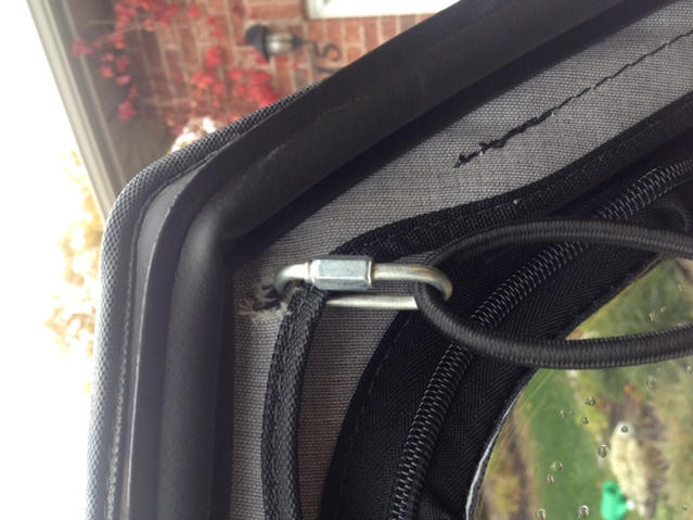

I've got a set of Best Top Full Soft Doors coming.... they do not have limiters .... I also couldn't find a kit that would provide for such.... am I wrong to think I will want a way to stop the soft doors from 'flying' all the way open when open? Trying to be proactive here... I'll be most concerned about the doors hitting my mirrors I'll use with the soft doors- specifically some euro style aftermarkets from autozone (?) I modified to mount on my windshield frame.... any one buy or make or 'rig' something up to limit the soft doors?

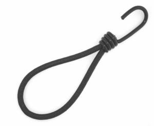

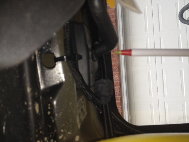

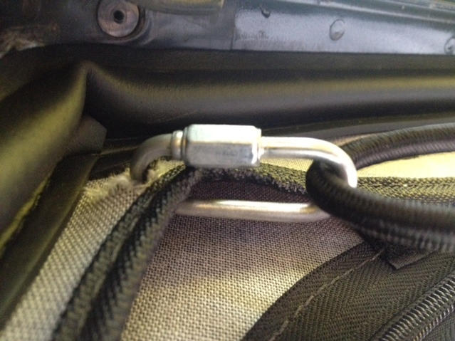

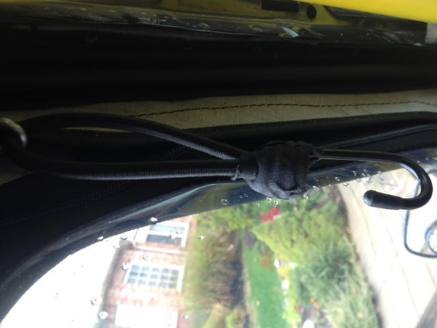

I used these and they work perfect 6" I believe and the door won't hit mirror and stretches enough to easily get out (hook the one end to door.... The loop goes around factory hook... ALSO to avoid the top part of door flapping bad on long road trips or windy and rainy days ... I'll post pics later after work how I used these too to keep upper 95% closed..... You can ad a grommet to the part where you cut a hole in the Bestop extra material part..... and it hooks to the frame of your sunvisor..... SORRY DON'T KNOW WHY PICS CAME OUT SIDEWAYS
