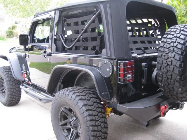

35x12.5x17 with 4.5" of backspacing. This is how far they stick out.
Name:	Bestop & Safari  001 (Small).jpg
About 2" past the bushwacker flares. I'm at work so don't have a straight on pic. I do at home though and can post it later if you want.
Attachment 582115
Thanks for the pic! So, given that my tires are 11.2", I guess they would only stick out about 1" or so, that's not to bad i dont think.
Old Oct 29, 2014 | 11:15 AM
14Sport's Avatar
Joined: Nov 2013
Posts: 3,703
Likes: 8
From: The Dirty South
Well 1.3" narrower would have to be split between the inside and outside of the rim so they would stick out approximately .65" less than mine.

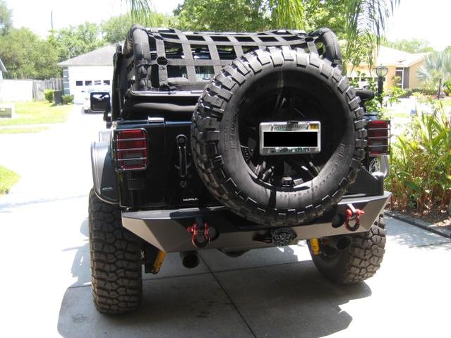

Here's a better shot.Click image for larger version

I run those wheels and you would want the 4.5in backspacing or you are going to rub bad and end up getting wheel spacers down the line.
37x12.5x17 with trimmed fenders any only about an inch and a half out
