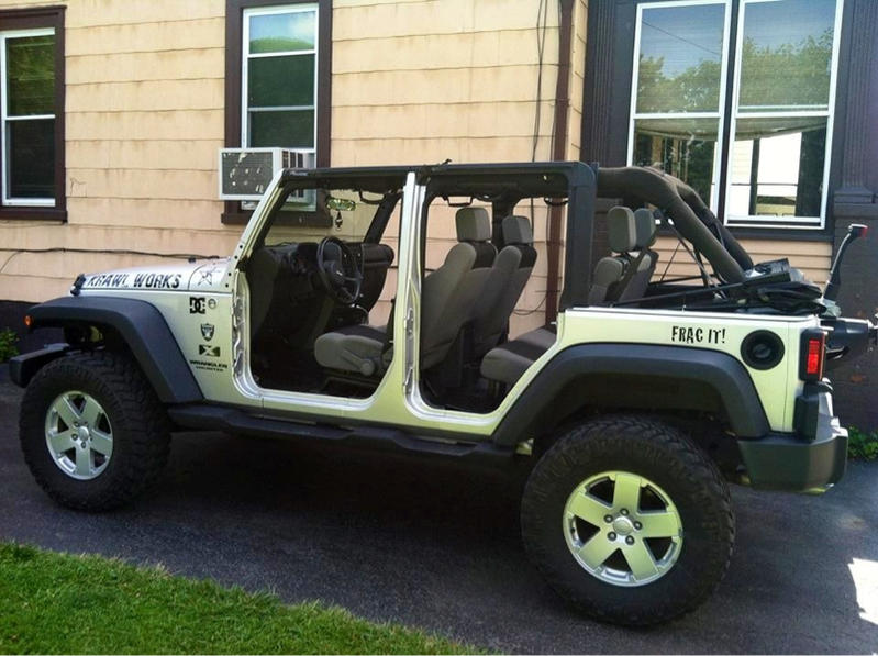

Jawhn7's Avatar
Posts: 129
From: Pa
35/12.50/18 nitto trail grapplers on stock 18 wheels with 1.5" spacers... 3" bds suspendion lift, rc 1.5" body lift been runnin this setup over 2 yrs now... Not 1 problem yet...
