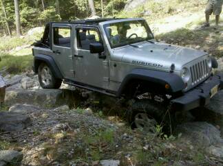

I have the 2" Teraflex and love it!!
U definately want longer sway bar links.
Sent from my Droid
That looks good rink! Did you use the supplied sway bar links that came with the Teraflex kit?
