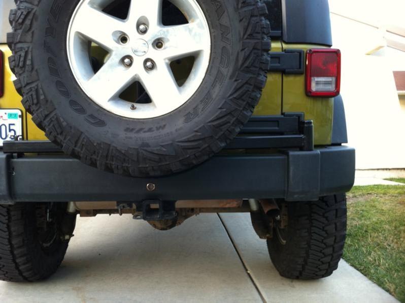

You could always go with homemade tire carrier.
