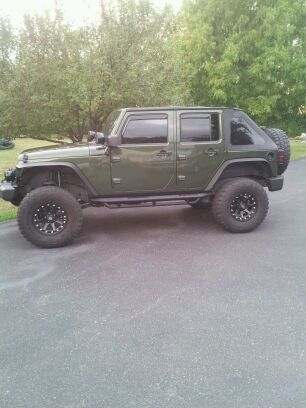

That's what I run. An adapter bolted to the stock mount.
What size tire is that? How much lift? Looks great!
Sorry for the late response
The lift is a 4.5" BDS kit and the tires are 35"

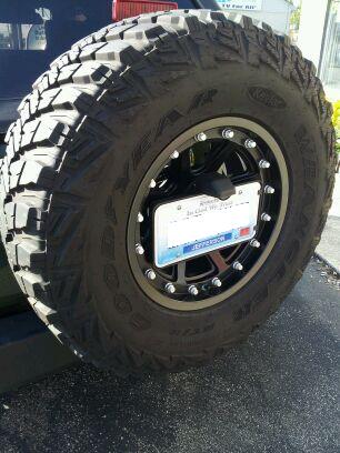

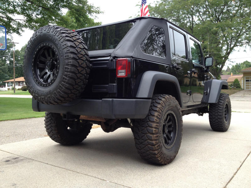

I have a 1" wheel adapter mounted behind my wheel and it fits fine.
