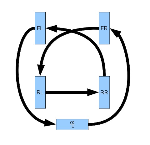

Originally Posted by 14Sport
I use a different pattern because I like the tires changing direction every time.
Right !
Like this:
Name:	Wheel Rotation.jpg
