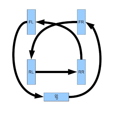

Originally Posted by GJeep
Right !
Like this:
Attachment 626205
That's the pattern I use.

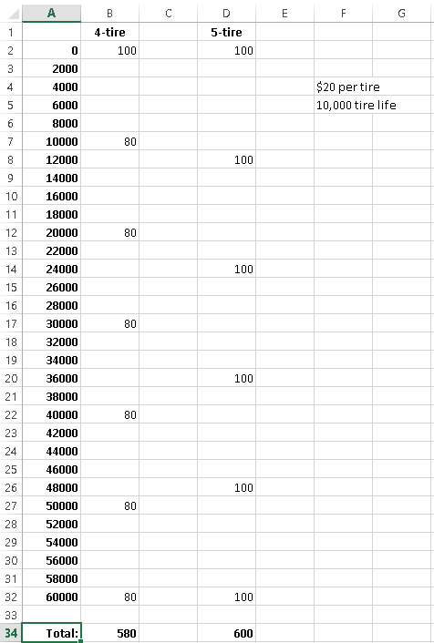

Quick spreadsheet check assuming 20 bucks per tire and 10k tire life. Both start with 5 tires.
So it all comes down to how long the spare will last on the rack before you have to replace that too when you're only rotating 4. And there are a lot of variables there...covered vs not covered...hot vs cold...dry vs humid...age when bought...etc.. The $20 in this example is actually the cost of the tire. So more like $160-?.
So I stand by my original guess...if it lasts 5 tire changes it's a wash.
Right !
Like this:
Attachment 626205
This is how I rotate mine. I don't think its that big of a deal either way, as long as you use the same pattern everytime
