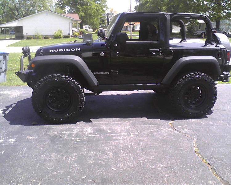

Okay...I am thinking my Jeep may be smarter than me I just upgraded to a set of 35x12.5 Fierce Attitude tires (love these tires by the way). I expected my speedometer to be off by between 9 and 10 percent. So the first time I got on the highway, I quickly cross-referenced the speedo with the speed reading on my factory navigation, and the two are still reading exactly the same.
I originally assumed the navigation system computes speed via satellite, but how could that be possible if they are reading exactly the same both before and after switching from 32's to 35's? Is the speed reading on the factory navigation system somehow connected to the speedometer reading on the dash? That is the only thing that seems to make sense to me. The only other explanation is that my Jeep is really smart and realizes she is running on 35's now, so she adjusted her speedo to save me a few bucks.
Does anyone have an answer for this???
