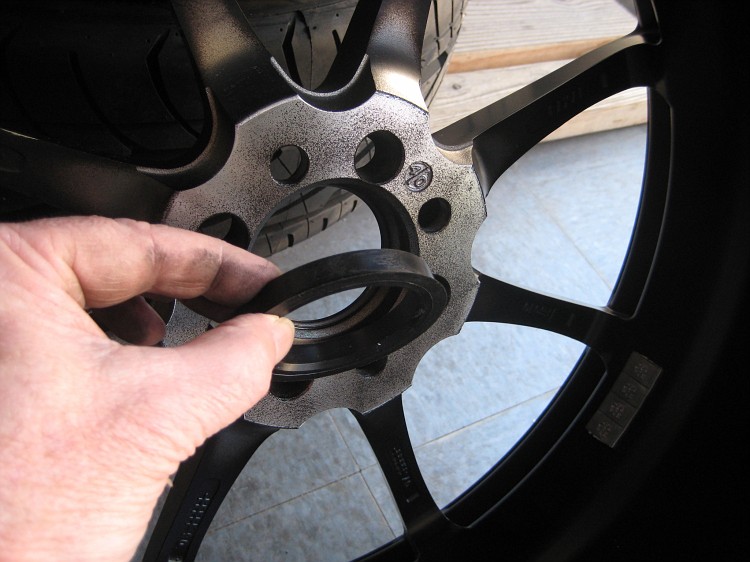

Also, can anyone tell me what compound I need to put on the lugs?
The guy told me I needed to get a set of plastic rings from a wheel store I have never heard of these before.

Red Loctite on the lugs, but I have no idea what plastic spacers he's talking about. Did they come off a JK? With the 5x5 spacing?

I think the plastic rings are to make non-hubcentric rims compatible with the hubcentric spacers. If you are using stock rubi wheels you should not need these.
