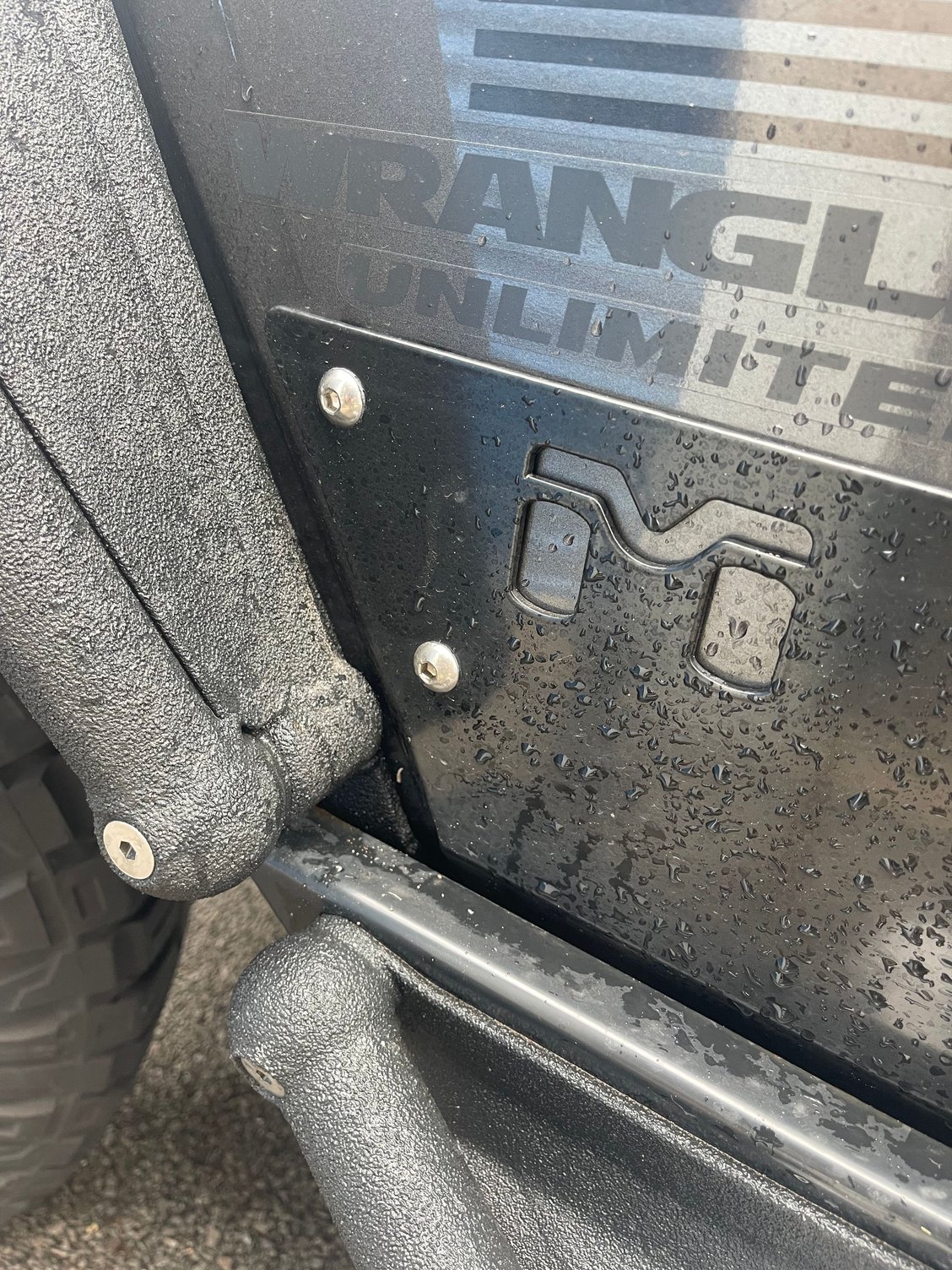

Well, got a worst case situation with a spinning rivnut. I was swapping out the stock Metalcloak black oxide 3/8 button head bolts to some stainless that won’t corrode during the lovely Ohio and West Virginia winters with the salt and stuff and I got them all replaced except one. I had three others give me a hard time but I was able to get the bolt to break free by pulling out on the rocker guard and creating pressure on the backside (mushroomed) of the rivnut. But this bugger won’t break free. Spins in both directions. It was the last one I had to do also.
I’m pretty inventive when it comes to this kind of thing but I worked on it for about 45 minutes and was starting to get frustrated so I stopped before I did something stupid that I would regret later.
One of the things that just popped into my head is maybe, just maybe I can access the backside of the rivnut by removing the insert of the MC vented fender liner kit that covers up the area in front of there. My other idea is to possibly get a metal plastic trim tool under the head of the bolt and try tightening the bolt down to maybe get the rivnut to catch and tighten back up again.
The main reason for getting the hardware out is to get the rocker guards off so I can get them Bullet Lined on the outside to match the Overline Fenders. Purely cosmetic but I’d like to do it before winter if possible.
The rivnut in question is the upper left closest to the fender.

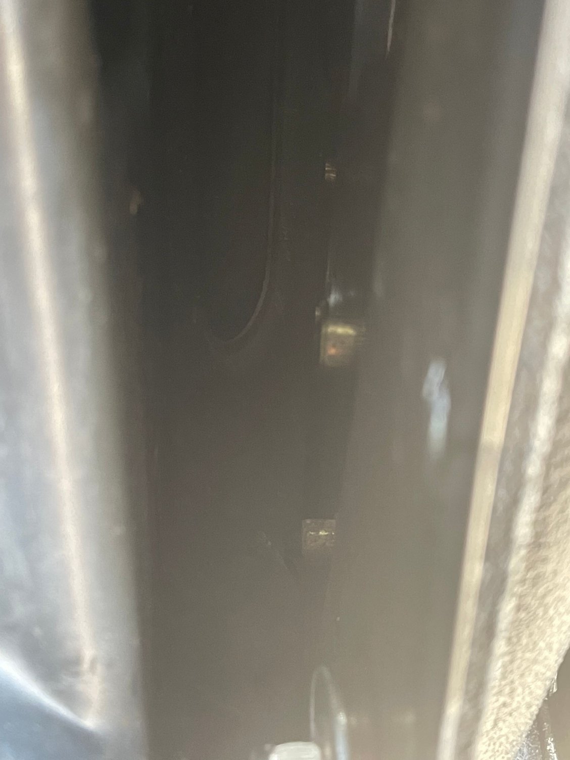

So, just to follow up with this post and what happened and hopefully help someone searching for the solution to the same problem in the future, @resharp001 was correct about accessing the rivnut from the fender opening as I also thought could be done. I pulled the insert out, grabbed ahold of the rivnut from the backside with a pair of channel locks and 15 minutes later I was back on the road all buttoned up and happy with my new non-corroded, anti-seized, stainless buttonhead bolt.
Pulled the insert out
You can see the offending rivnut here at the top
Old bolt removed
Retightening the rivnut using the MC rivnut “Tool”
New bolt installed with a liberal amount of Loctite marine grade anti seize compound on the threads.
