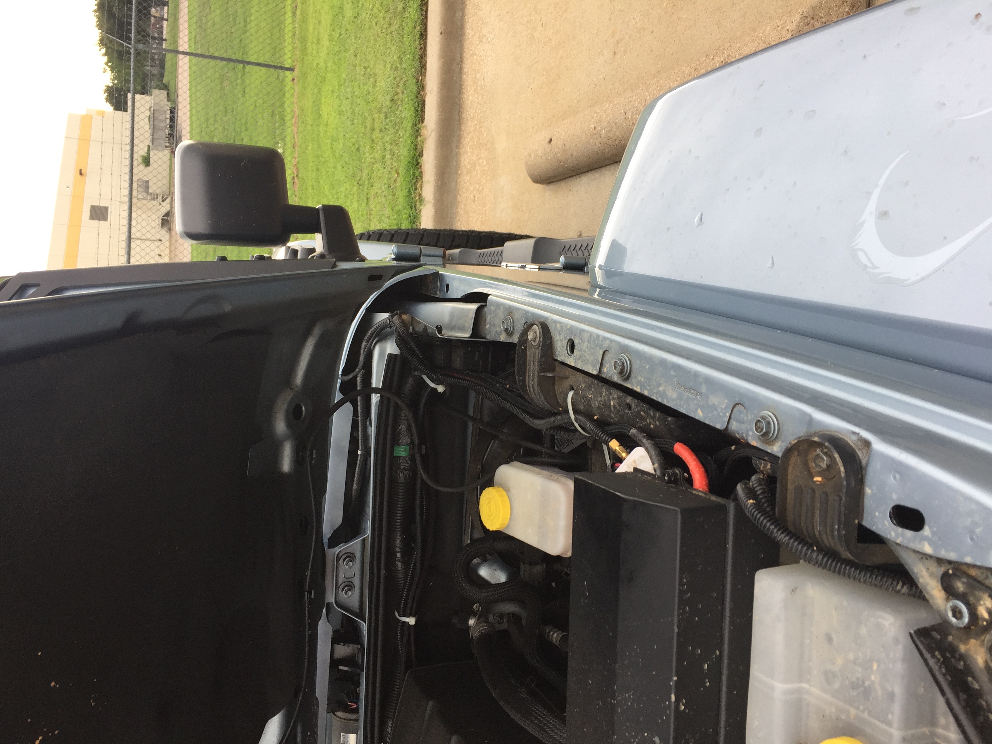

I used the grommet on the drivers side with the rear washer fluid line run though it. I pulled the grommet, made a small cut in it and pushed the cable through. Then I re-installed the grommet and sealed everything up. Hope this helps...
Thats how I ended up running mine through as well. I am quite pleased with the looks after the install was complete.
