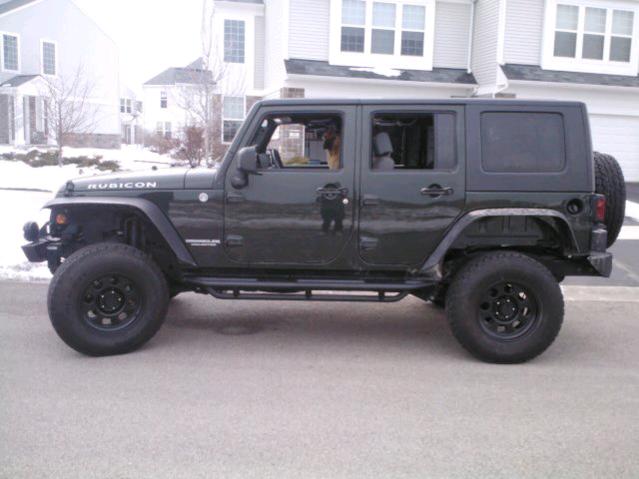

I would just keep the factory steering stabilizer and save the money, the dual bilstein is not going to do anything for you performance wise.
For a real nice ride on road and off I would look into the 2" old man emu paired with their nitro sport shocks. It is a real nice ride. I ran the hd coils and got about 3.25" of lift so unless you have a real heavy rig I would go with the standard load springs. I did run the 5100's on their coils as well and though the ride was better with the ome. I still run the ome shocks on my jku today.
You will have the room to run a 35'x12.5" tire with the factory flairs and should be able to fit 37's with flats and extended bump stops.

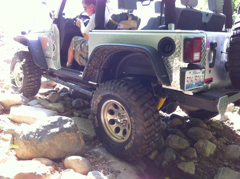

I had tons of room with flats and the 2" ome. Here I was running a 33x12.5 tire.
