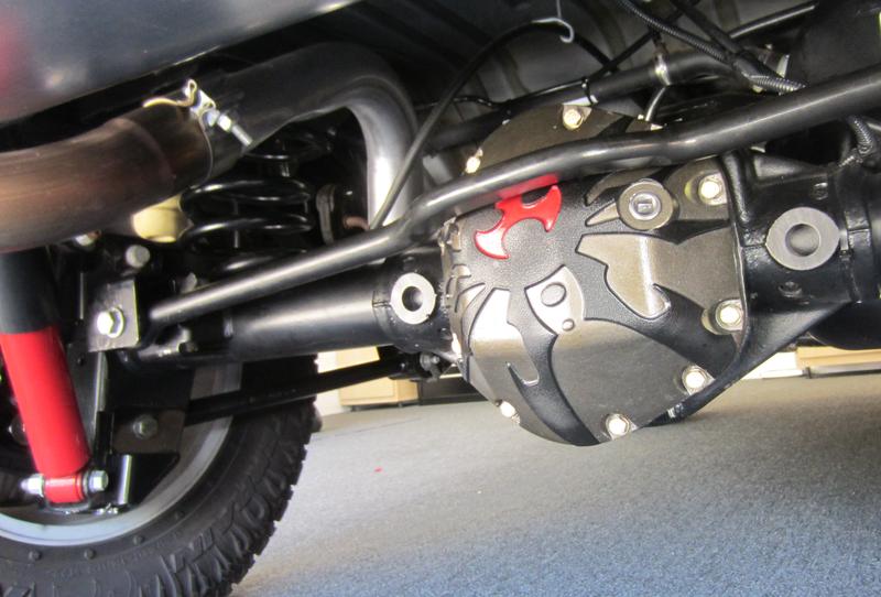

I just installed one on the rear of my '13 Rubicon. Top quality and a bargan for the price compared to the others. No reason to spend more money in my opinion unless you just don't like the looks.

They make covers for what ever Dana you have. In the case of a Rubicon, the 44 in the front is the same as the rear. However... the stock track bar in the front will not clear a heavy duty cover and that including the PS. If you want to place one of these in the front, you'll have to replace the stock bar with one like the TF adjustable that is designed to clear fat covers like these.
The rear track bar does clear just barely and I did some grinding on mine for insurance.
The reason for placing one of these on the rear is to avoid the most common rock vs diff issue, which is breaking the cover seal on the bottom by draging it over a rock and loosing your oil. That won't happen with one of these.

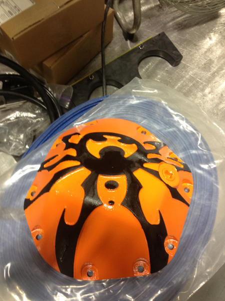

Also running poison spyder covers. Man they are thick!! I like the looks better on PS and riddler opposed to arb and such.
Attachment 482462
That orange/black spyder is nice. If I had a orange Jeep, I'd be going... hmmm
